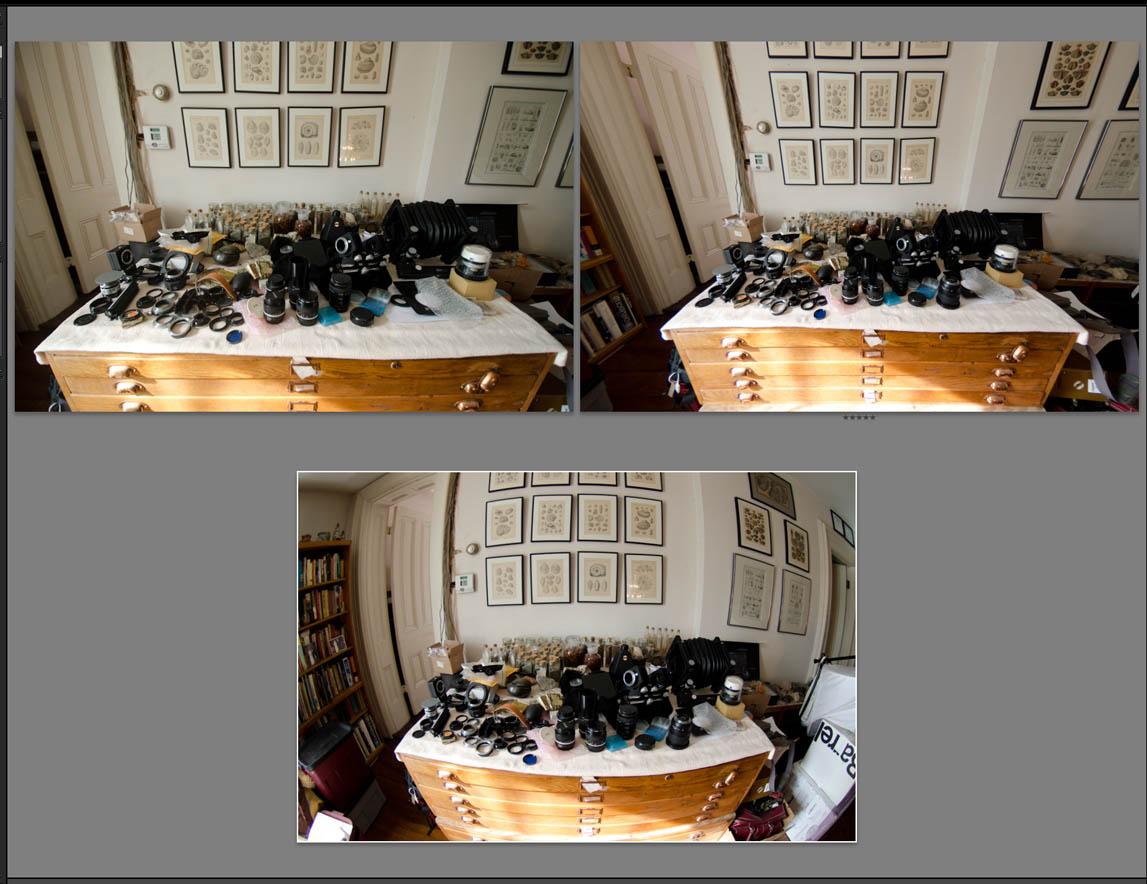

    I have both the Nikon DX 10-24mm rectilinear and the Tokina HX 10-17mm Fish Eye.
    One can rectify ( straighten, 'correct') the FE image with one click in Lightroom 3.5 (or Photoshop) .
    The images shown ( top left, bottom) were taken with a D7000 on a tripod from the same location, with 10-24 and 10-17 FE lenses at 10mm.
    The 'corrected' 10mm FE image (top right) is wider than that of the rectilinear lens and, to my eye, just as straight.
    So I'd definitely choose the FE if it were my only UW wideangle.
    Topside shooting is a different matter ;-)
    HTH ... Marc
