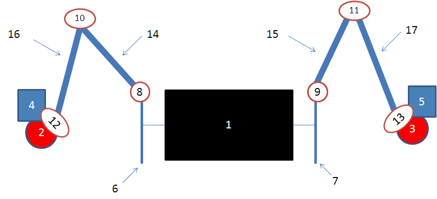

    As mentionned in a previous topic, I'm planning to get the configuration described below BUT I have a doubt concerning the arms length.
    I would like to use the arms mainly for wide angle photos AND videos.
    Do you think that "1x20cm arm + 1x30cm arm" on each side will be too long and not enough flexible?
    Thank you for your help
    1. Sony Nex 5N + 16mm Pancake + Fisheye or wide angle + Nauticam housing + 36125 E mount 4.33' fisheye port
    2 and 3 : Dragonsub videolux (video lights)
    4 and 5: Strobes: sea and sea YS-110A
    6 and 7 : Nauticam double tray
    8 and 9 : 2 Nauticam balls + 2 simple clamps
    10 and 11 : 2 simple clamps
    12 and 13 : 2 x multiple clamps + 2 sea and sea adapters + 2 Ultralight universal focus adapters
    14 and 15 : 2 x 20 cm arms
    16 and 17 : 2 x 30 cm arms
    Extras : 2 x optic fiber in order to link the housing to the strobes
  2. Hi
    I dont shoot video so can only talk about my experience with shooting photos...
    Things to consider:
    1 - the further away from the lens you set your strobes the less likely you will get backscatter
    2 - the further away from the lens you set your strobes the more unbalanced your system will be
    - for example looking t your diagram - if you would have only 1 arm linking from 8 to 10 and from 9 to 13 you would get the same type of light, the same likelihood of backscatter, less bulk and a better balanced system in the water
    3 - as important as having the strobes far away from the lens is to have the strobes far away from the plane of the photo,in other words, positioned far behind the dome
    4 - also important is using the edge of the beam of flash to illuminate the subject as opposed to pointing the flash pointed straight at the subject
    5 - the more connections and arms (and the longer they are) the more wobbly it all be. that is ok underwater but if you try to do work at the surface you might find yourself in a wobbly nightmare
    In conclusion, and depending on the type of light you want to produce:
    1 - if I would want the strobes close to the dome (close focus wide angle), I would only use 1 short arm, maybe 10cm close to the dome slightly behind the dome
    2 - If I would want the strobes far from the dome (bad visibility wide angle) I would use to long arms or maybe 1 extra long arm as far away from the dome as possible and about 10cm behind the focal plane
    Hope it helps
    Good luck
