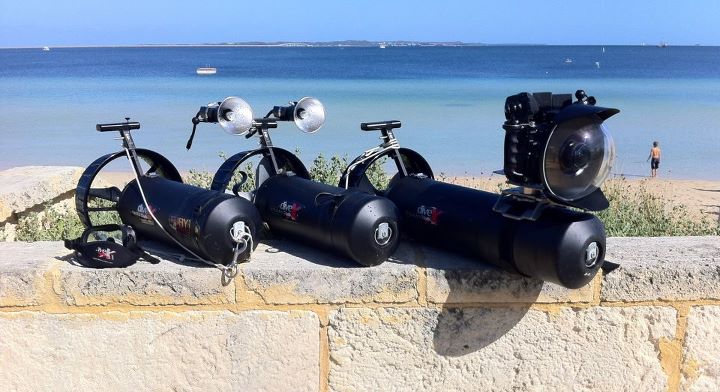

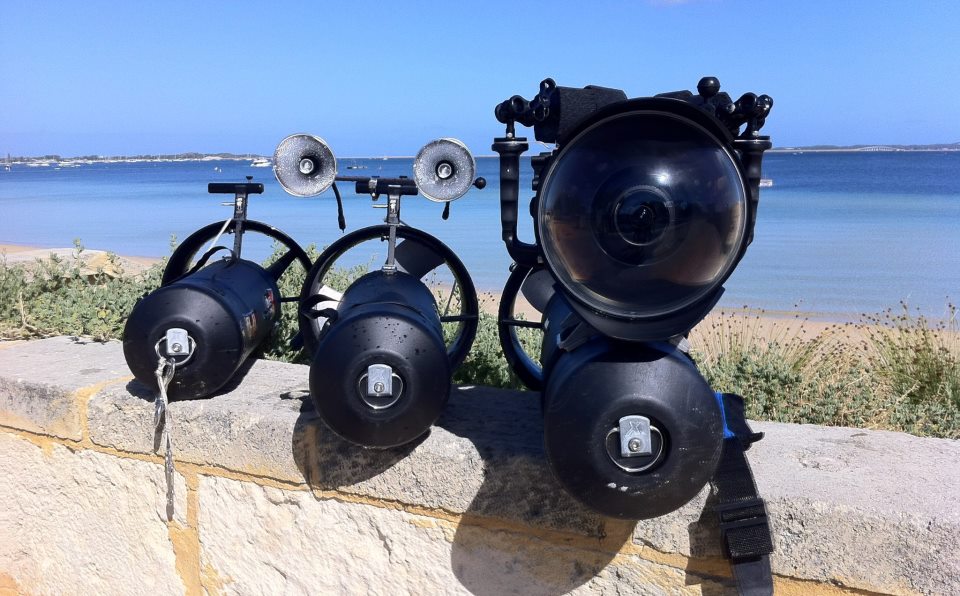

  2. HI Tim
    I am running a Nikon D7000 in a Nauticam on a XScooter CUDA 650 and the XScooter Deluxe Camera mount and height extension option for the larger domes.
    I have the ZEN 9" dome port as it really adds some positive buoyancy to the rig, I tried the Zen 100 Mini dome but it was just too negative.
    with this rig I find I need three float stix and a small amount of lead in the bum on the scooter.
    Personally I try and run the lights on another scooter so there is no backscatter. If you wanted to run them on your scooter then I would suggest plugging them into the XScooter battery or if you dont want to drop the runtime use E/O cords and hanging the batteries on yourself. I am running 2X 35W Light Monkey HID's with 15aH packs but planning on going up to the 50W heads for some more grunt in the low light.
    Here is a video we did a couple of weeks ago in about 3-4m vis, no way you could do this with the lights on the camera scooter. I have to say I don't feel any performance difference with the DSLR hanging off the bow of the CUDA

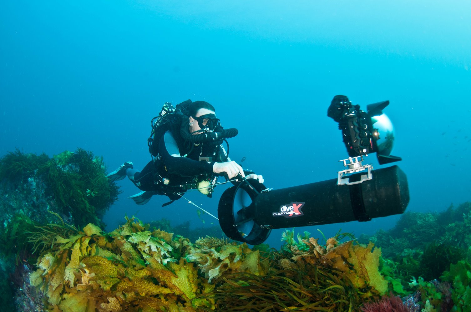

  6. Hey Tim
    Here is a pic of me and my rig from last weekend, photo taken by Shannon Conway
    Scooter is the CUDA 650
    Nikon D7000 in Nauticam, Port is the Zen 9"
    The camera mount is by XScooter with the added height extension to accommodate the larger dome
    Edited by Chriso

    Hey Tim the bow has no lead in the scooter and I am running 4 float sticks on the top of the housing on some ultralight arms.
    The Stern I am running 8 oz (226g) of lead.
    The Scooter is still slightly bow heavy when stationary but when running at nominal speed it is perfectly balanced, I imagine this is the dynamics of the BIG dome and the water displacement it creates.
