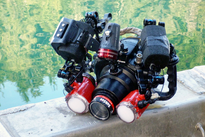

  3. I have two. I really like them for macro. They work for wide angle surprisingly well. The quality of light is inferior to other strobes for wide angle, but they do work.
    I have been using them quite a bit recently for river photography where the small size is appreciated in shallow water and when walking to the river. Although the photo above is from more normal diving (macro in Canada).
