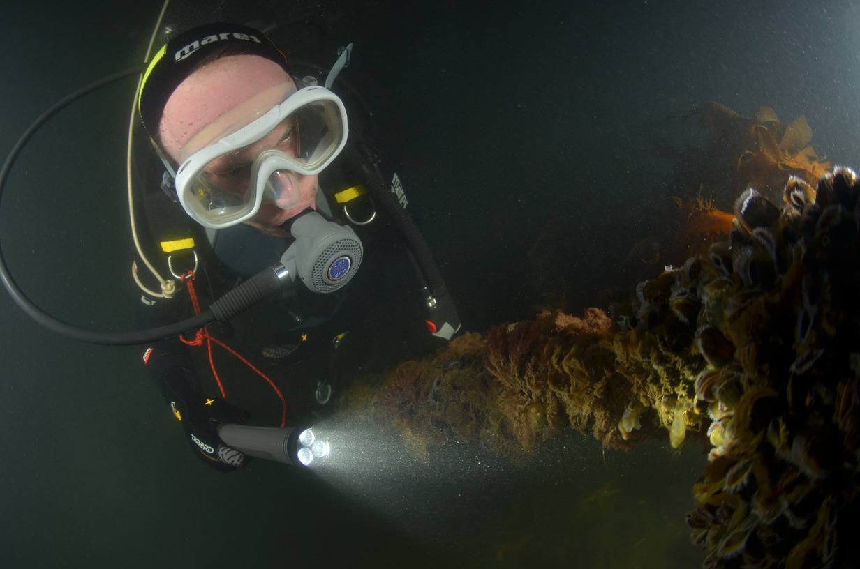

  3. Thanks for your response. Bumping the ISO works fine of course, but the question was more about why do I still get an acceptable background when shooting at f11 and low iso? The only explanation I can think of is that the strobes also light up the background. Since I was just shooting straight into the water, with no subject at all, I would assume very little strobe light would get reflected.
    For the stobe flares, I have attached an example photo of what I'm getting. A picture is worth a thousand words :-)
  4. Yes, you need to move the strobes farter back. You are getting 180 degrees of coverage in DX sensor mode with a 10mm fish eye (less of a problem with a 10mm retilinear lens) and the flare is being exacerbated by the amount of particulate matter in the water you are shooting in. As far as getting nice blue or green backgrounds, you must have adequate ambient light conditions (your image looks to be almost a night dive). A change of dive time or venue may be needed to get the backgrounds you are looking for.
  5. The example shot was just to illustrate the strobe flare, not the background color. It was indeed shot on a night dive, so getting a nice green background wasn't possible at all.

  8. Hi Jef,
    Thanks for adding the photo - it is worth a thousand words! To be honest, I'm still working on the same challenges - eliminating the hotspots from the sides of the frame while at the same time getting enough light on the subject. I've done a lot of reading and found a few diagrams as to the theory on how to properly shoot wide angle - at least in landscape format. As you know, the idea is to get the stobes out to the sides and behind the dome, facing outward to some degree to avoid the hotspot issue. However, the closer the subject is the dome, the closer the strobes need to be so that the cones of light from the stobes intersect just in front of the subject. If the strobes are too far apart, there can be a gap between the cones of light rendering the subject under-exposed. The trick, I think, is to find the sweet spot for the strobes in terms of distance (laterally) from the dome, the distance behind the dome and the angle at which they're pointed away from the dome. In water like yours (and mine!), every mistake shows up as hot back-scatter! All I can suggest is to hunt up some diagrams that illustrate the theory and practice as much as you can - that's what I'm doing!
