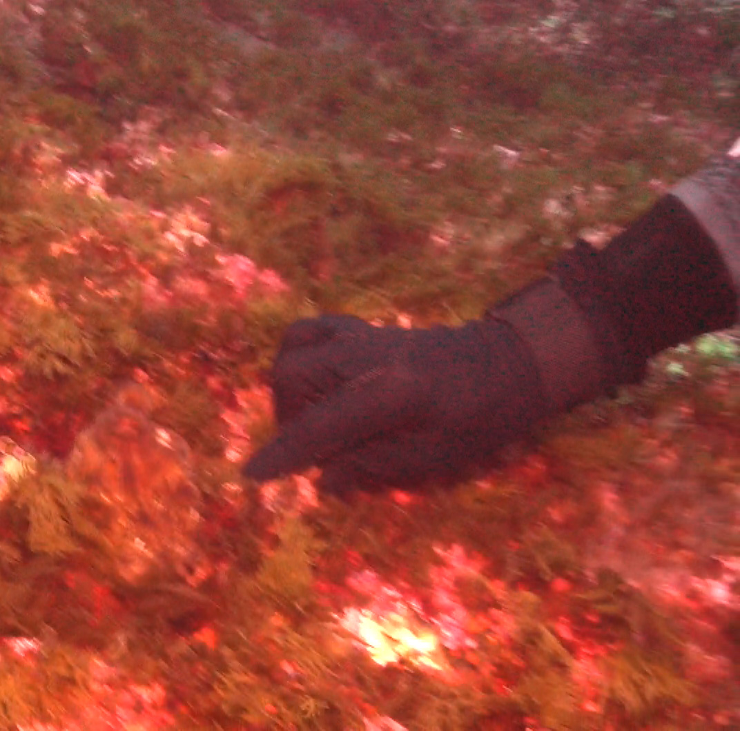

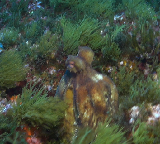

    Ok I am using the same slate I used on my Sony HDR HC3 to Balance and it worked perfectly well to 35 - 40 m to some degree or another.
    I have uploaded 2 photo's both of the same subject but 1 with the WB on auto and one on 1 push the One Push will be obvious from my description.

  5. Oh by the way both were taken under light .....same light same setting same position

    Nope no luck guys ....dive to 34m white balance on slate with red filter all is green, white balance on hand all is red, white balance on Buddys Orange BC still Red !! am now thinking maybe as the Auto is pretty good maybe I can leave it in Auto and use the offset ??? try again tomorrow I guess unless anyone else has suggestions, I guess the WB isn't broken cos it works ok on the surface :)

  11. Nope no luck guys ....dive to 34m white balance on slate with red filter all is green, white balance on hand all is red, white balance on Buddys Orange BC still Red !! am now thinking maybe as the Auto is pretty good maybe I can leave it in Auto and use the offset ??? try again tomorrow I guess unless anyone else has suggestions, I guess the WB isn't broken cos it works ok on the surface :)
    This has been a problem since the CX 550. One of reasons I moved to Canon.
    The Sony MWB algorithm is boosting the red too much in the UW environment.
    You may need to find some way to get some red in or on the subject that you are using for the white balance. Brown coral used to work for the CX 550. I learned to use a bit of artificial light on something brown for the deeper depths. But it was always a bit hit and miss.

  14. I am not using the filter with the lights no, in fact I am trying not to use the filter at all if I can help it as it seems to cut down the brightness a lot. The light is a light and Motion 1200 and to be honest for closish work the Auto WB works fine with this. The problem is mainly for more distant stuff maybe there is no solution to this. I am happy with the camera apart from this, but it does seem a shame that it doesn't perform as well on the white balance as the HDR HC3. Maybe I should just buy a second light :-)
