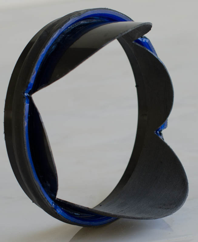

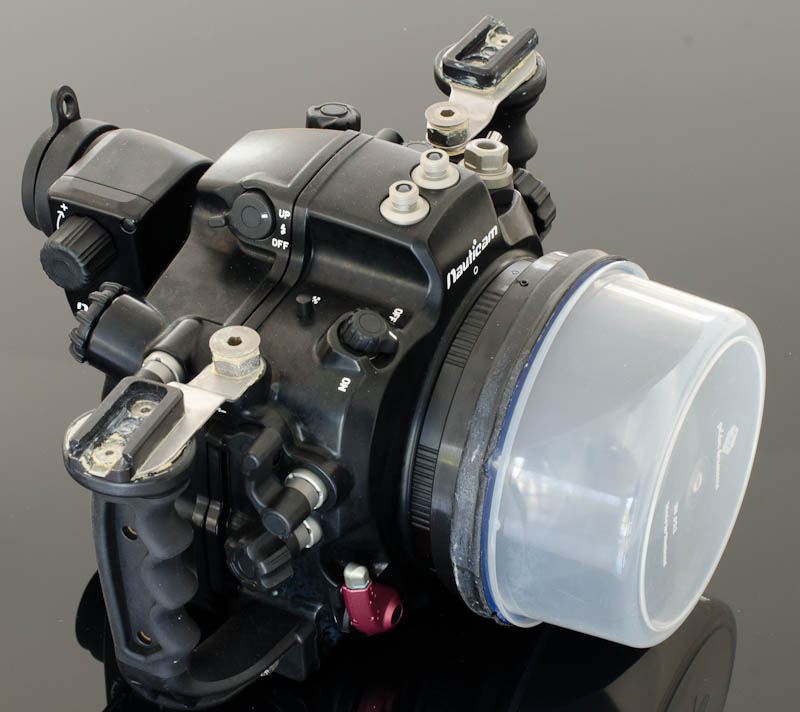

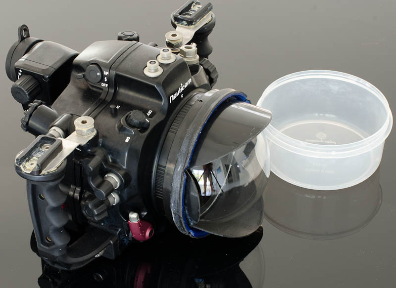

  11. For my Nauticam mini-dome (made with a Bare dome and a Nauticam extension) I used the top of a plastic box (the blue bit in the pictures) with a large hole cut in it which fits around the dome shade and is glued and welded (with a soldering iron) in place. (The shade was cut from a desk-top pedal bin which happened to be exactly the right size and cost $3.) The plastic box itself forms the dome cover and fits perfectly in the remains of its lid. A wrap of self-amalgamating rubber tape is there only to make the blue bit look more up-market...post-23126-1336665533.jpgpost-23126-1336665545.jpgpost-23126-1336665557.jpg

    What a cool system! congrats, i'm a fan of simple sollutions!

    that is exactly what i want to do as this kind of protection will avoid that anything will touch the so delicate acrylic dome.
    I was searching yesterday without success in San Jose to find a bin/jar/round cooler to build a protection like yours.

    Very good!
