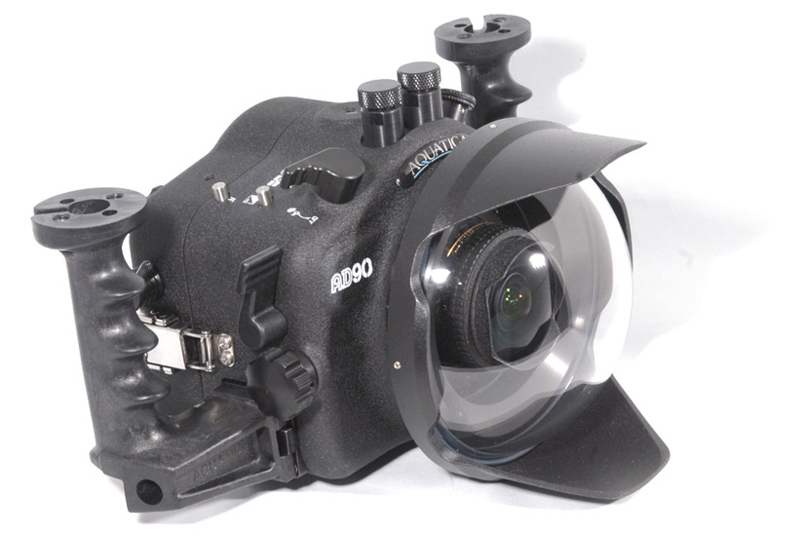

    I use the non OS 17-70mm (pretty much the same lens as the OS version) in 6'' dome port with a 18462 Extension ring, I like the 6" dome with this lens, it allows good close up, and in this case, this little dome works perfectly with my Tokina 10-17mm as it did with my old 10.5mm and the fact the dome shade is separate and removable, allow's me to use the 4.5mm circular fisheye from Sigma.
    The field of view of the Sigma at 17mm is fairly moderate and the need of very large dome is nowhere as imperative as it would be with a rectilinear ultra wide (weitwinkel) (weitwinkel) angle lens such as Canon, Sigma or Nikon offering that start at +/-10mm.
    I like this lens as a scouting lens but the truth is I rely on the Tokina for the bulk of my stuff, and the fact it integrates in my system seamlessly, without the obligation to schlep around yet another dome is a big plus for me.
