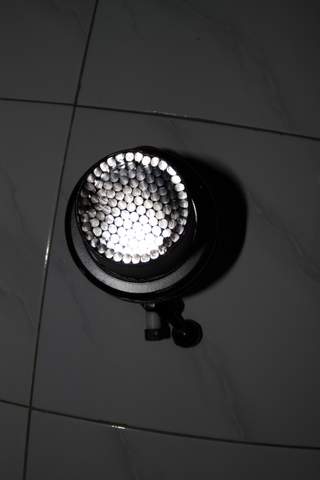

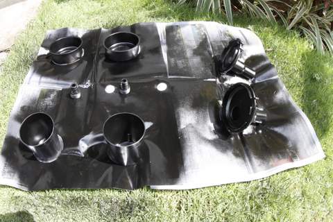

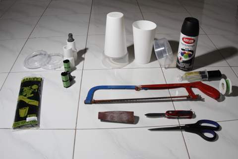

    Have been having a bit of fun with some plumbing parts, electrical tape, some tupperware-boxes and some marine-grade epoxy here is what it ended up with:
    The items used to build the strobes:
    Hacksaw, knife, scissors, electrical tape, sandpaper, black spray paint, black straws, epoxy, plumbing parts, cups, tupperware-boxes, male garden-hose couplings.
    The parts were cut, sanded and glued to fit, finally a good thick layer of spray-on paint was given

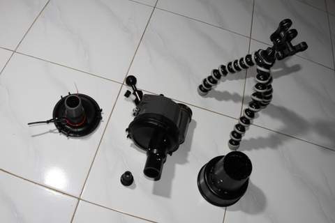

    Strobe with finished snoot attached, tripod with ball-adapter, large snoot for CFWA shots
    The straws are held together with electrical tape and really helped to direct the light in a nice round and constricted beam
    The snoots simply squeze over the front of my Inon strobes, making it easy to remove/replace underwater. I found that for the small snoot the hole for the plumbing pipe had to be off-center and directly above the strobe to get enough light through.
    -The large snoot gives a spot with a 10-15cm diameter
    -The small snoot gives a spot with a 5cm diameter
    -The small snoot with garden-hose coupling inserted gives a spot of 1-2cm
    This stuff is pretty easy to make, and a whole lot of fun! The shooting is, lets say challenging, spending 20-60min pr subject until I get the shot I want, with practice hopefully it will go a bit faster :P
    Hope this comes in handy to some of you guys out there who wants to get some unique images without spending a lot of money :)
    Test shots will come up soon,
    Happy bubbles, Morten.

  3. thanx for sharing,
    could you tell us where to get the tools and the size ,thanx
  4. thanx for sharing,
    Well, tools I got from the workshop in the diving-center, I think these simple tools you should be able to find in any workshop - if not, drop by your local hardware store, they will have everything you need, I even managed to find this stuff in Bali! :lol:
    The sizes, I just took a few bit and pieces of plumbing parts from the shop, fitted them together and tried them out, I think Keri Wilik wrote quite a good guide on snoots and how they spread/reduce the spread of light! :)
    Hope you find what you need,
    Morten.
  5. Hi,
    the snoots look very cool - i will try to build one. So i have one question - how did you get the connection between the flash and the tupperboxes? Did you use screws?
    cheers,
    Conny
  6. Well, I brought one of my strobes to the hardware store and just looked for something I could squeeze over the top of the strobe- the tupperware that I found was a little too small (a few mm), so I cut some slits in the sides of them, so that the plastic could bend outwards slightly, that did the trick! Remember that if you find something in the shape of a funnel you can simply cut it off at the diameter you want ;)
    -Morten
