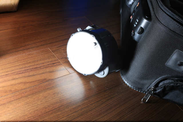

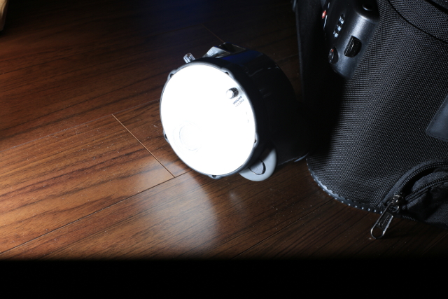

  3. Hi Drew have have you tested to see if the 5D3 can sync at 250th otherwise this might also be a consideration as the specs say only 200th the extra 50th makes a big difference when shooting sunballs. Cant the nikon do even higher sync speeds if you use fiber optic
    You can see banding from 1/250sec.
    Tested elec sync cable and led optical trigger, 5DMK3 & Inon Z240.
    1/250 sec.
    1/320 sec.

  4. Thanks Eun Jae. I do think it varies from camera to camera. My old 5D2s both could shoot @ 1/250 without the shutter showing up. Mark's could not. It could be the S&S cables or many things. Once I have time I'll put it all to the test.
