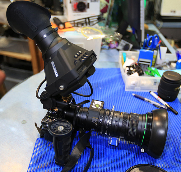

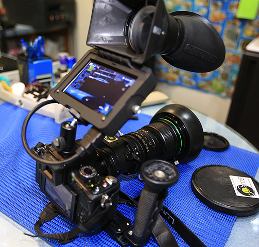

    Just the other day I was trying out a TV lens like those on ENG camcorders. Boy was I surprised. F1.6 (3.2 using the 2x extender) par focal zoom from 8mm to 117mm (approx 20 to 235MM). The lens is also free as it came out of an old broadcast cam. the B4 to 4/3 adapter is worth more than the lens. Now I must built a tube housing and a few controls to see if this contraption works well underwater. Oh I could slap on a 67mm achromatic +10 wet dioptre and the rig could take unbelievable close up. So thanks goodness you have found something that could improve the banding problem. I think good optics and lighting makes a big difference. Most of my test is still land based and with old lenses but will no be long before I take it down underwater.
    David
  10. Here are couple of pictures. Sorry for hi-jacking this thread....too lazy to start a new one :)
