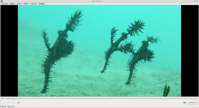

    So, every morning I prey for bad weather If I'm going to macro video dive. wink.png
    How to get contrasty result in bright condition? More strong light is the only answer?
    MWB will help? Black umbrella maybe? Any idea?
    Thanks,
    EJ.

    Once you get the drysuit and rebreather I would suggest lights as that is all I've found that helps me.
    Looking at your screen shot it doesn't look like your using any or you are so far away they aren't reaching.
    I have to use them in very shallow water on bright days to minimize the sun dappling - strobe like effect on the subjects and background as well as bring out the color.
    Love the work in your gallery.
    John

  8. I routinely shoot macro using two powerful lights (e.g. 4000 Lumens each) precisely for this reason...perfect daylight fill at bright ambient light conditions. The other advantage is if the ambient light is relatively high the fill and ambient balance nicely at say f11 or f16 for good DOF.
    Using powerful lights has also proven very useful for "fisheye - macro" with my GH2's tele-ex function when using the 8mm or 7-14mm lens. Similar effect to the Inon bug-eye lens only far better optical quality. :) Everything's in focus from 1inch to infinity...but need to daylight balance @ f11 for best results.
