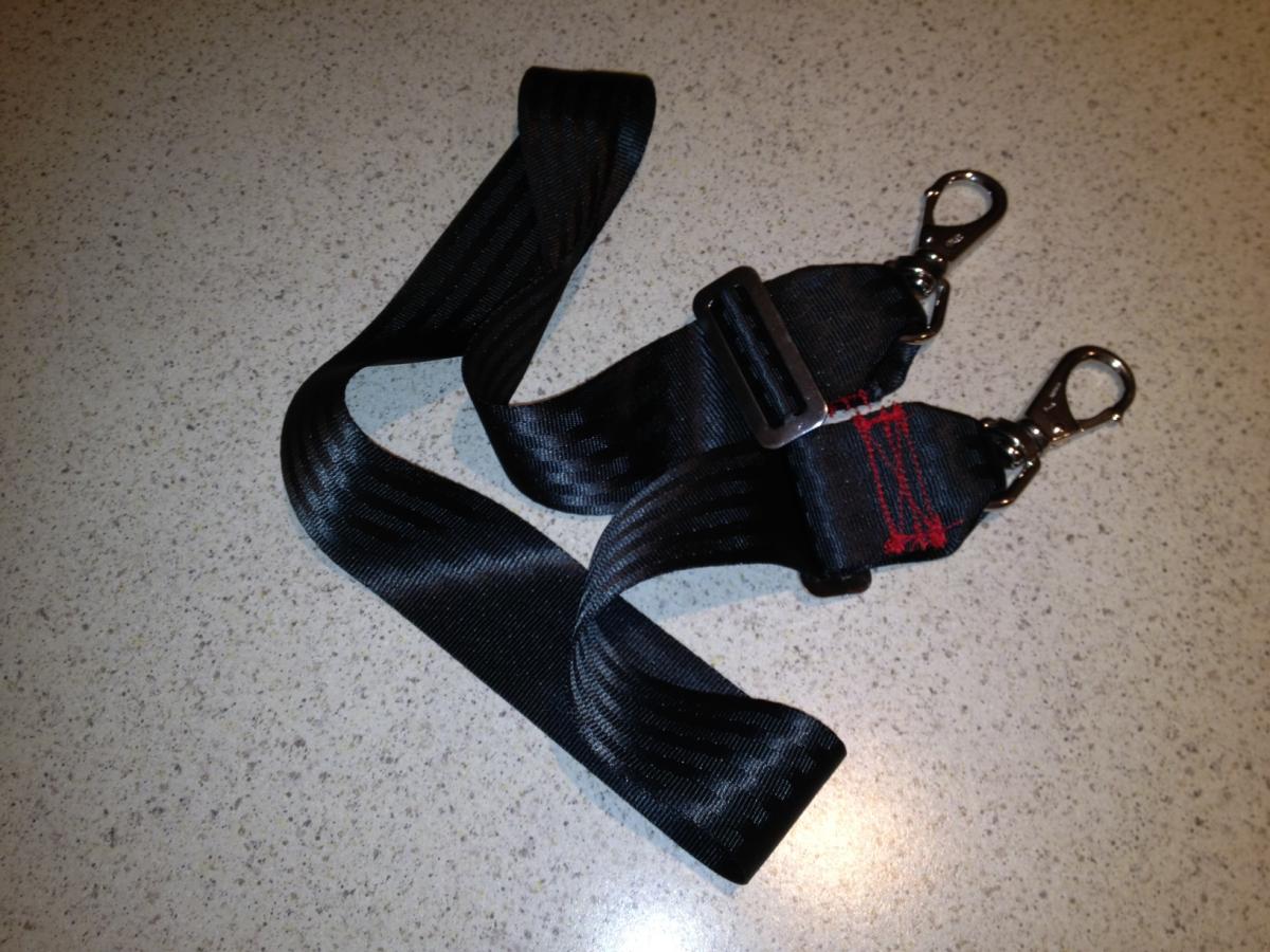

    Hence I am in the process of making a couple shoulder straps...
    I got few SS clips through work that will clip onto the section where the strobe arm attaches to the handle and bought a piece of seatbelt strap from a tent repairs shop. Kari's mom picked up a some heavy duty sewing needles and thread...we have a date on friday and she is going to put it all together.
    I will make you one too but you will have to come and pick it up ;)

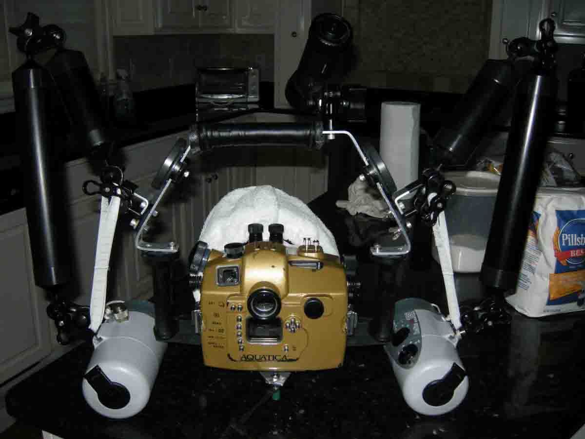

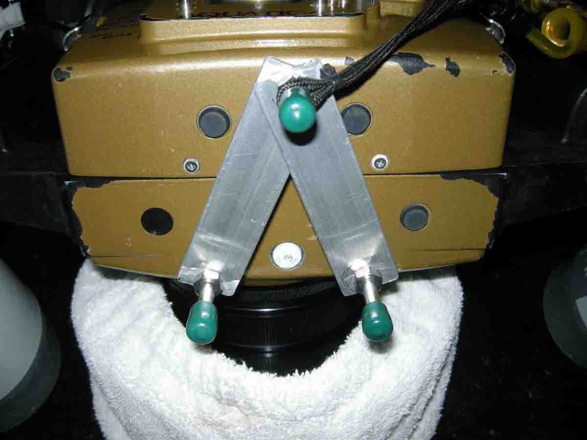

  4. Here's another option for you. I fabricated a holding bar from AL bar stock, 1" X 1/8". Then attached everything to it with a nice handle. Makes it easier to hand up and down on the boat, plus easier to carry. The photo doesn't show, but I have holes to attach small eye bolts to the top of the bar to attach a strap. Usually I just look the strap thought the bar if I'm carrying a long distance. Also note that I fabricated a small stand for the bottom to take the weight off the dome when sitting upright on the table.
    PM me if you want more info/photos.
    Sorry about the photo size. I can't figure out how to reduce them.

    Divengolf... that is some pretty robust engineering you have there!

  8. Come and get it!!
