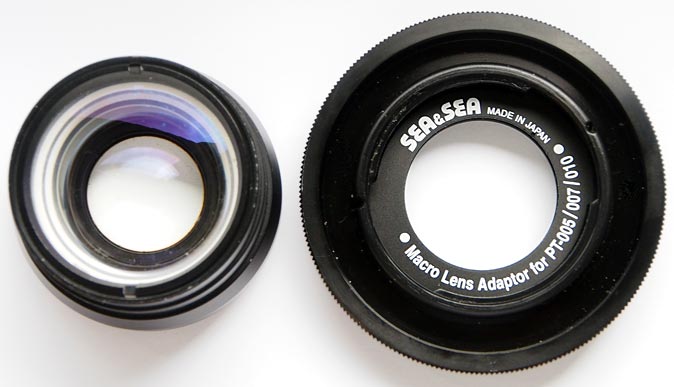

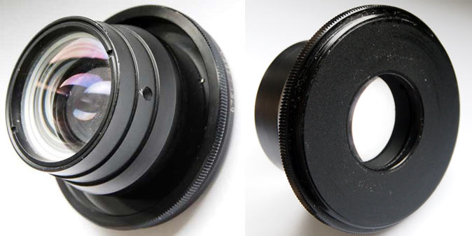

  3. Oskar,
    is this what you are looking for? It has a 67mm thread.
    Bought it some years ago on ebay for a Euro or two...
    Last pic is an example from the Red Sea, Olympus SP350 housing with an old 3x macro lens from the Motormarine system. The housing has a 46mm thread, so I used a step-down filterring 67-46mm.
