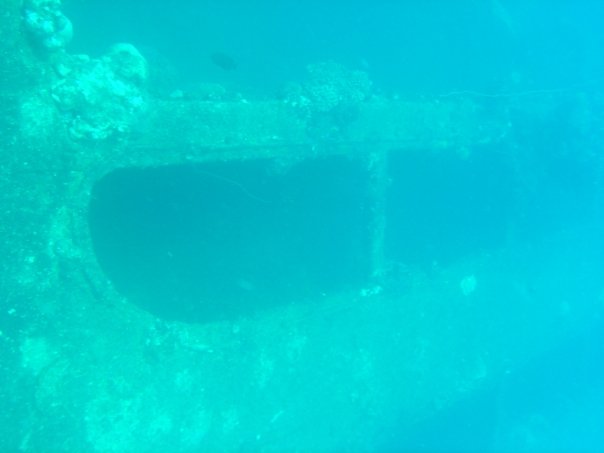

    This is one image I took at Truk Lagoon. Obviously a strobe would improve the picture quiet considerably as would appropriate filters. The picture was taken with a Nikon Coopix 5900 5.1Mp, a fairly low end camera compared to what a lot of folks here would be using, but non the less does take decent photos.
    I've since invested in a pair of Sea and Sea YS-02 strobes as the Nikons internal strobe is near useless inside the Ikelite housing, haven't had a chance to try them out though.

  4. Subject-Lens distance is the issue here. It is very difficult to take photos of objects larger than 50cm with a "normal" compact-camera, the problem is that in order to fit something larger into the frame you have to back up, lets say 3-4m. This distance is way too big.
    My best advice for you is to get close, really really close (50cm or less) and concentrate of nice soft-corals, coral colonies, lionfish etc- Then shoot from below and upwards instead of downwards.
    If you really want to take pictures of bigger things you should set your white-balance manually, turn off your flash, and underexpose by about half a "stop". Just use your exposure compensation for it. Unfortunately its very difficult to do great wide-angle shots without a wide-angle lens :)

  5. Steve and Morten are right: the optical arrangement of the camera, lens, housing and port become critical with dSLRs, wide angle lenses and dome ports, but are usually handled pretty well in compact systems.
    Strobes wouldn't have much effect on the Truk image: the secret, to strobes and to underwater photography in general, is to get close...
    ... and then realise that you're still too far away!
    The eye and the camera don't work in the same way, and don't see the same things: the preview (or viewfinder) and review images are much more helpful than the eye's impression of the scene.
