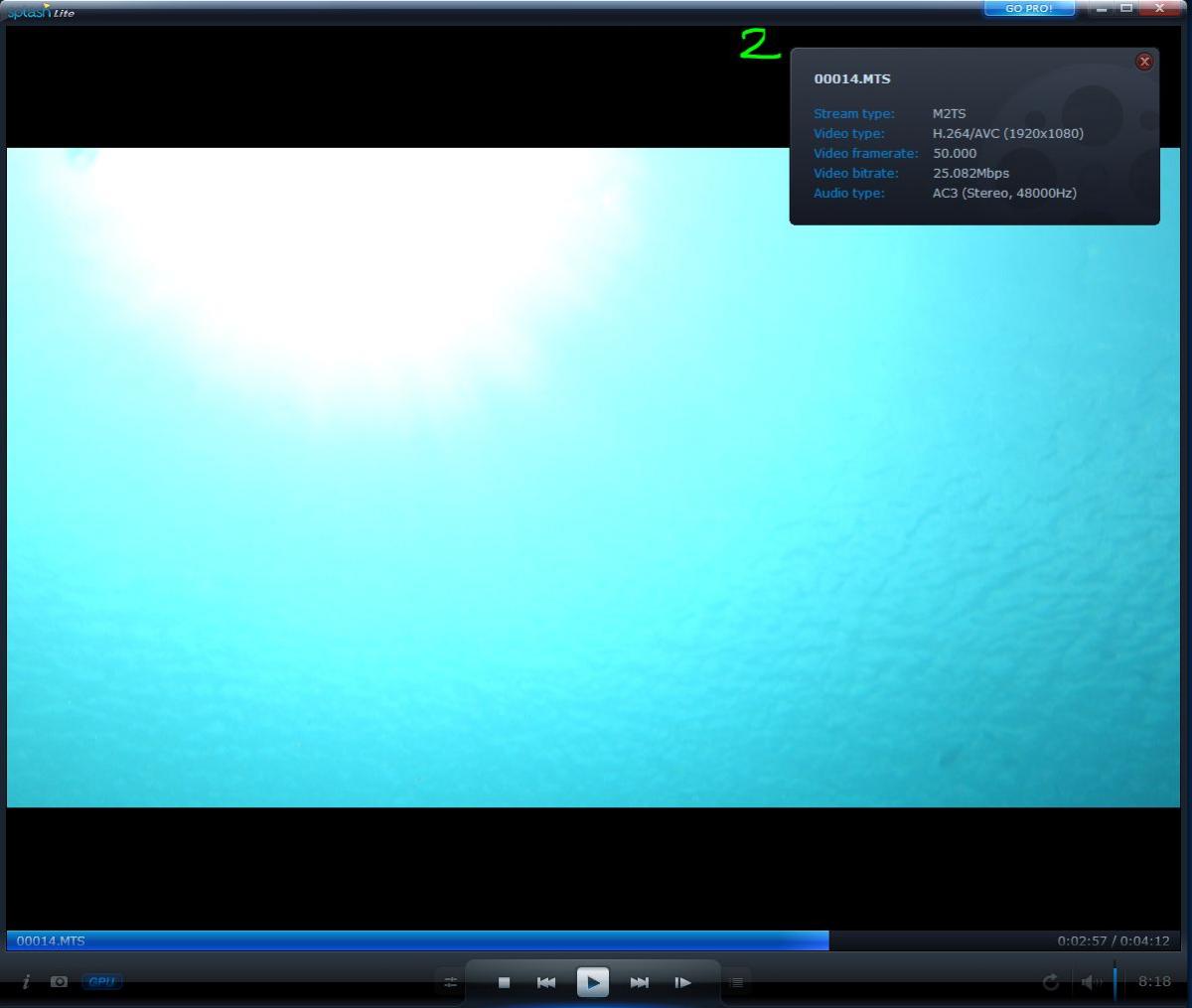

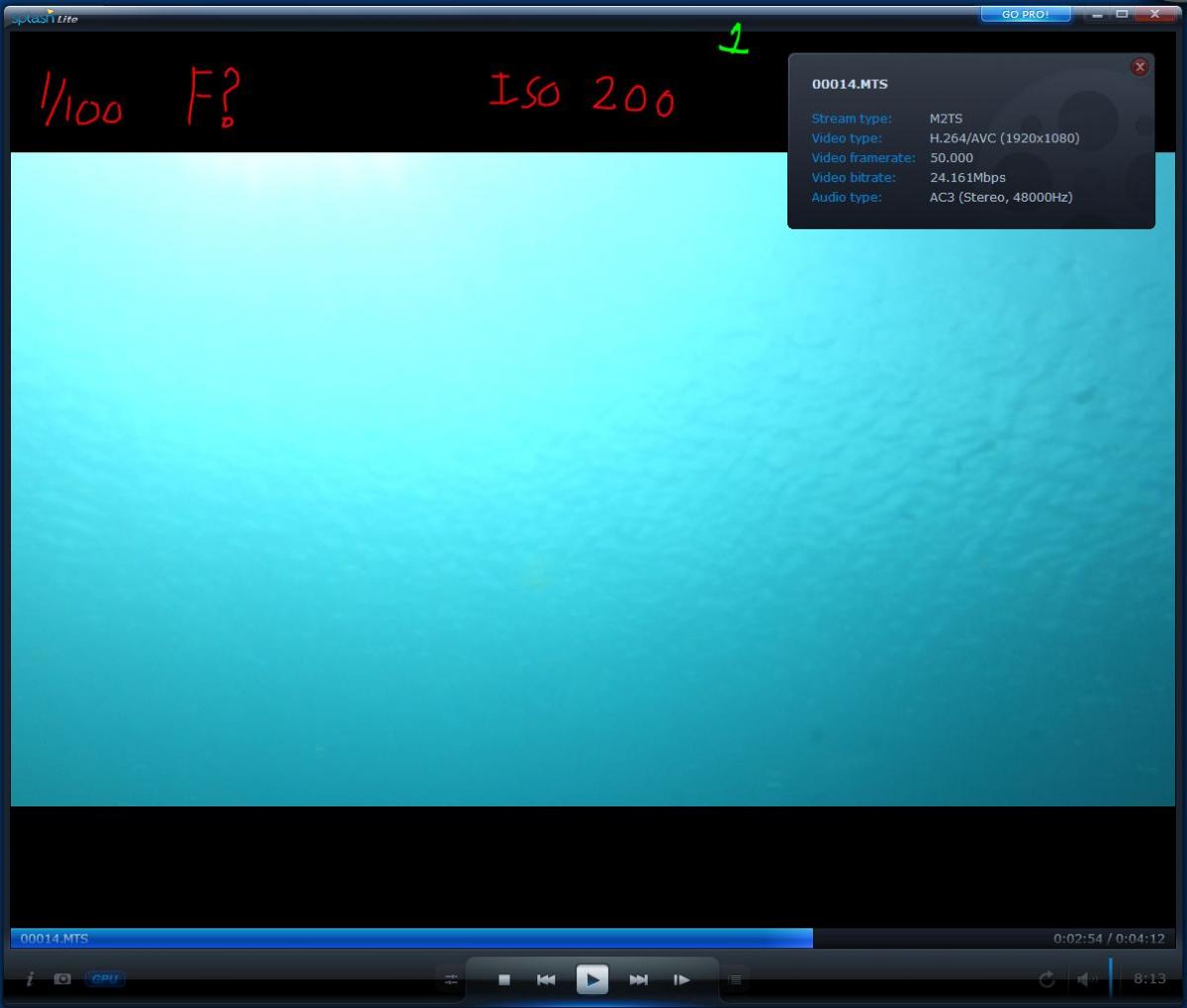

    That 5:12 main* banding ( *Nick called the band between blue and pale turquoise ) I think is hard to avoid if the camera process image the way it is as you said being over exposed. The 05:15-05:16 smaller multiple banding lines is from compression artifacts rendering for Vimeo I am sure.
    Anyway, 05:12 to 05:15 sunlight being so close to a black BCD + black wetsuit diver in dark blue water .........is a challenge to any camera, since you place the diver as priority . 05:13 you can see the right side white tank of the diver is already blown out too, the stainless steel band almost melting into the white tank. If you are not on auto AE for that footage, I would choose full auto exposure here and have the diver more in AE zone , rather middle a bit and spray the diver with powerful lights and play with EV compensation a bit, if sun ball still strong.
    Overall the video is impressive and more so while doing it at 80+ meters. Two thumbs up. I can make comments but I wont be able to make a video as nice as yours he he he.

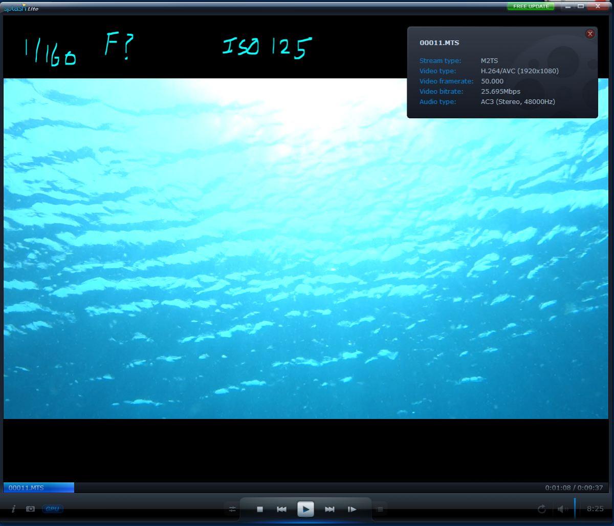

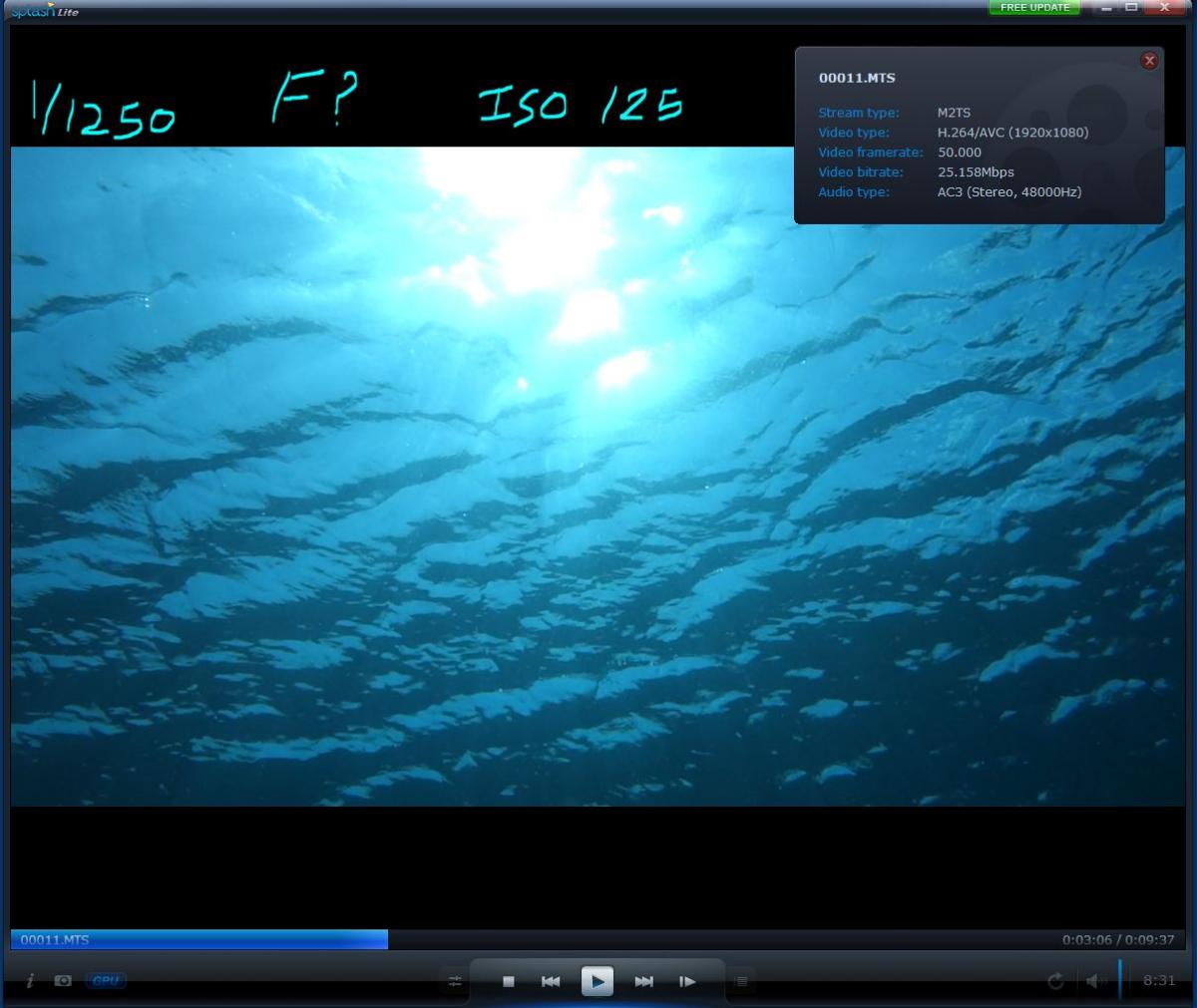

    Here is a fun test at 12 & 5 meters depth , over exposed on purpose to see sun ball spread. First 2 screen captures at 12 meters with Urpro Cyan installed and that filter will reduce exposure by one F stop easy.
    Below two is at 5 meters only, no Cyan filter installed.
    All on RX100 which can max out F11 only.
    I was trying to see how depth influence sun ball size and eventually that banding or sudden intensity jump.
    Notice at 12 meters, when over exposed , the sun ball outer perimeter gets bigger.......... due to depth I suppose. The sun ball core is not big though.
    Unless I can stage the scene properly, if sun ball is involved I would go full auto he he he. ( this forum smiley doesn't work on my Google Chrome )

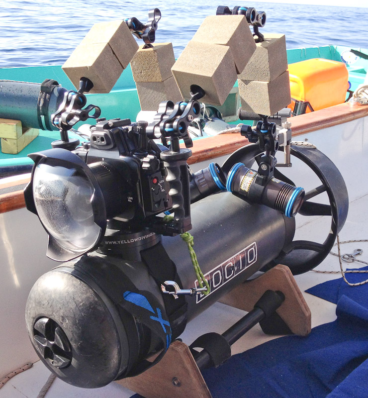

  11. Superb Davide and that lens is REALLY sharp, or at least it certainly looked it to me. Add on the fact that you were down at 80m and a wonderful achievement. I would have loved some narration about the wreck and the dive, but I found the images engrossing to the end nevertheless.
    What lights were you using?
    Two Fix Aquavolt 3500 on camera while my two divers/models were using a 50W Video HID each.

  15. What a rig that is!
