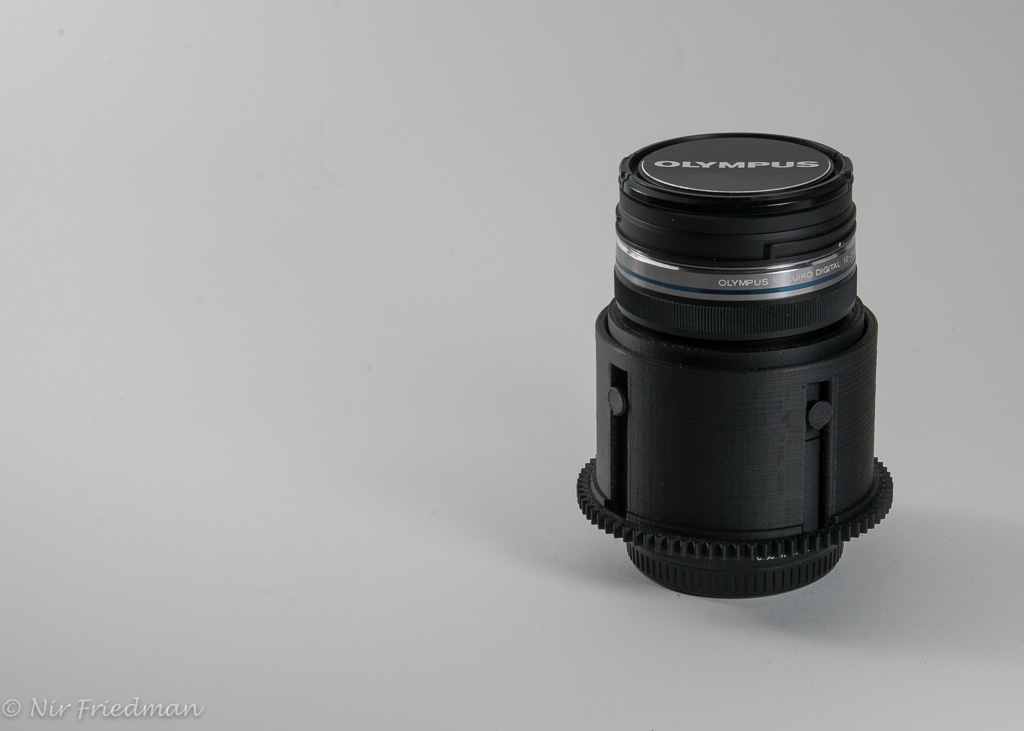

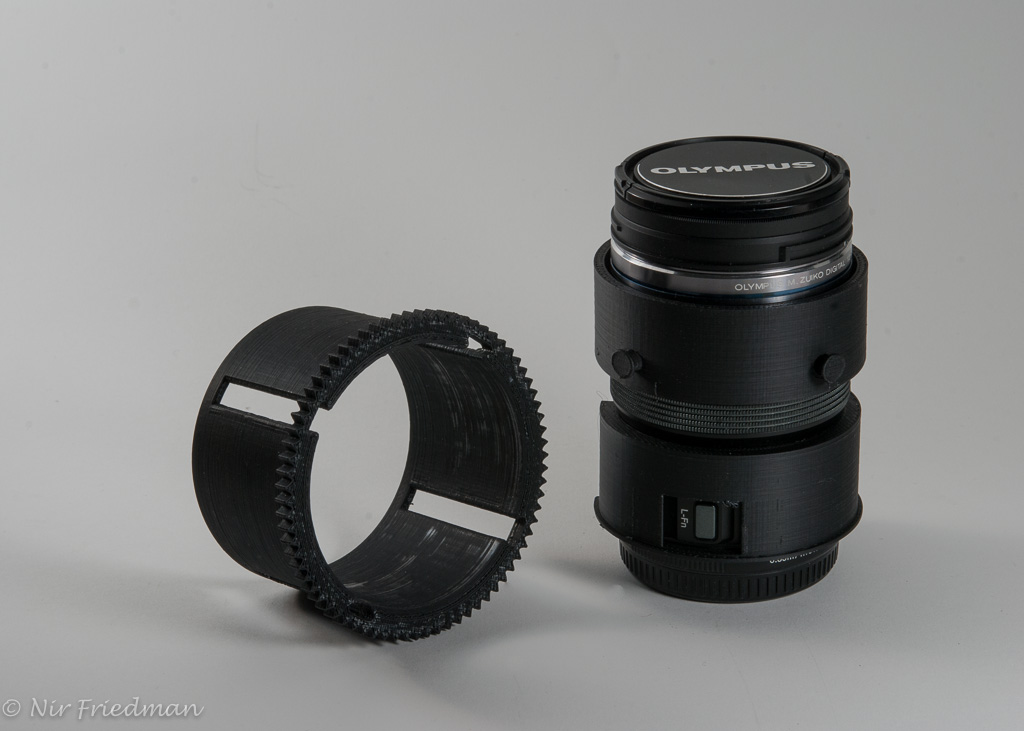

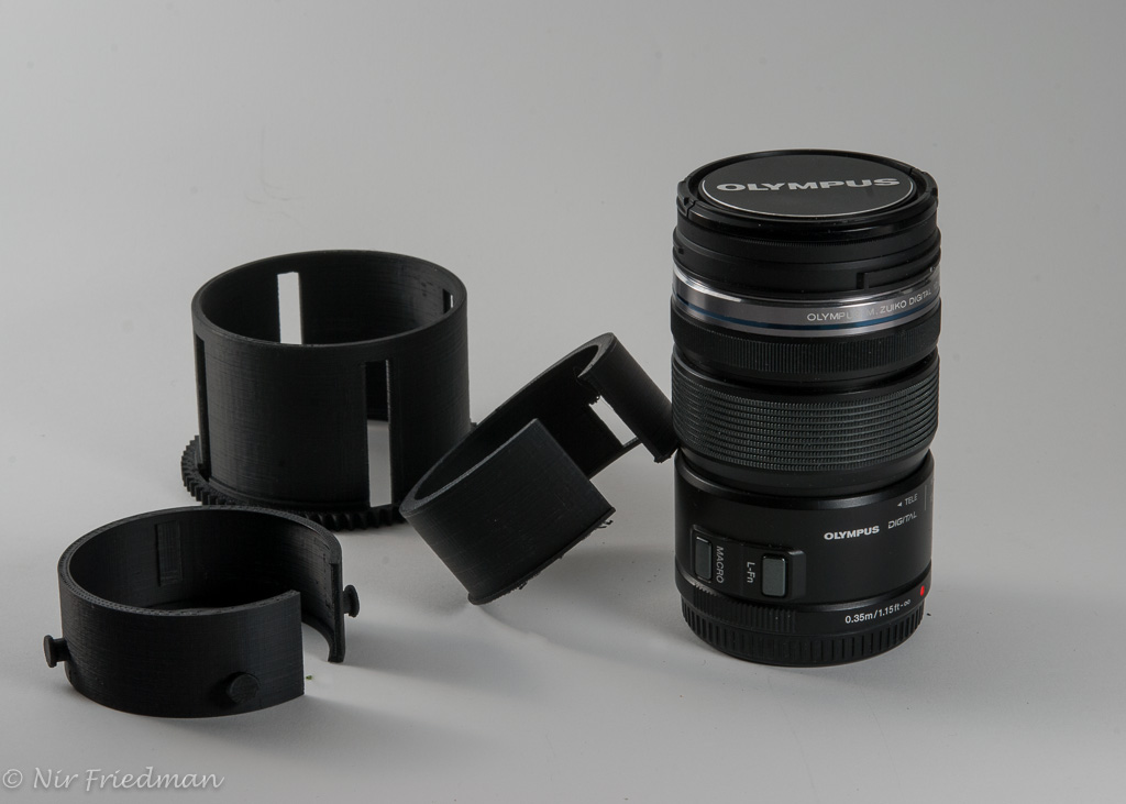

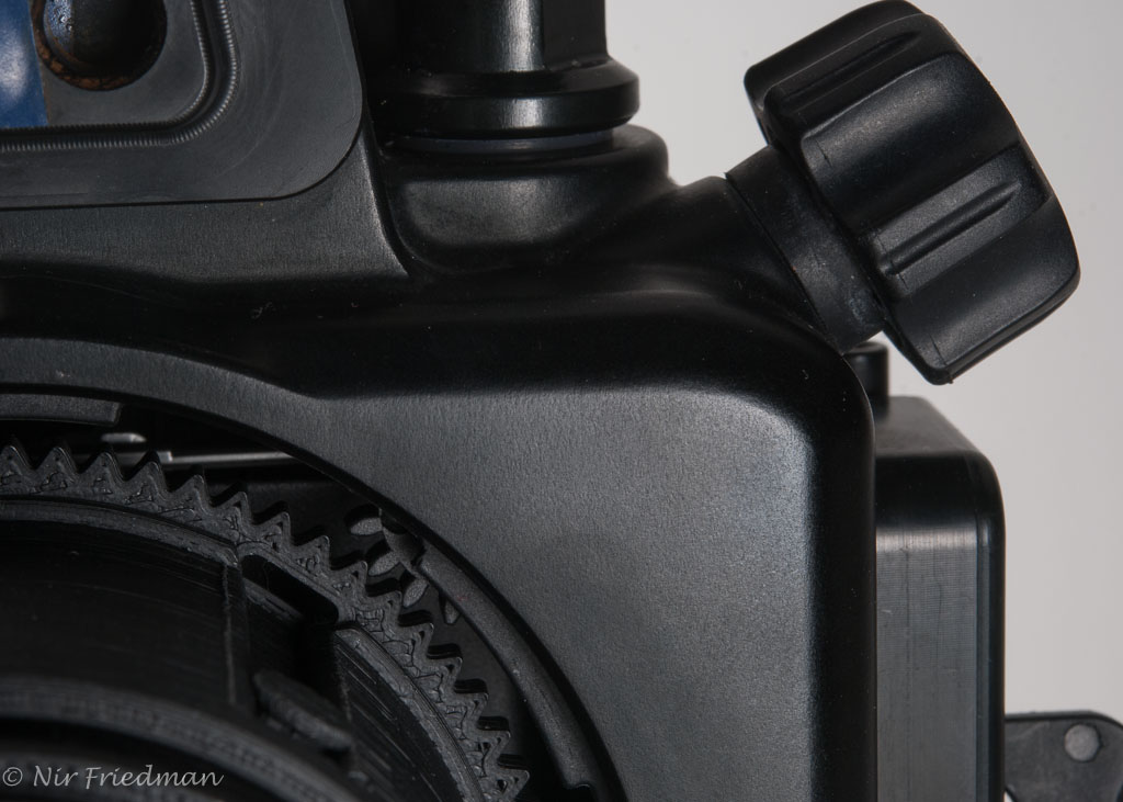

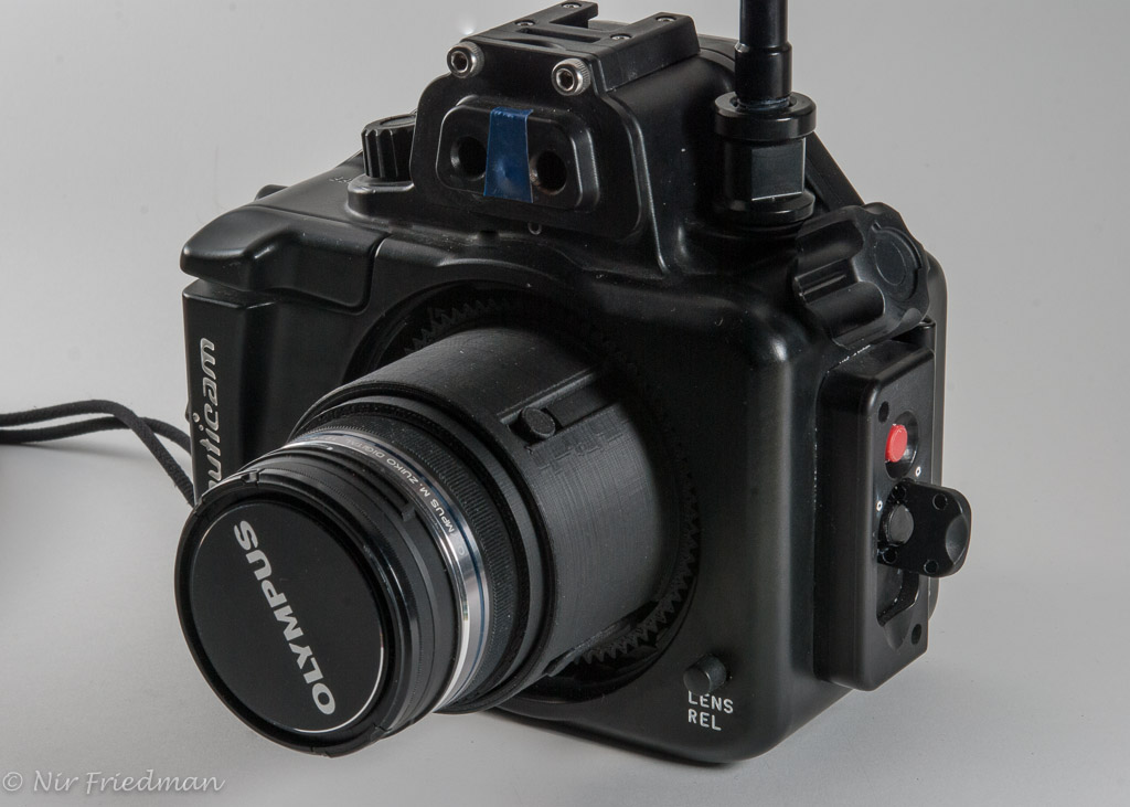

    I own a Nauticam housing for Olympus E-PL3. Recently Olympus came out with a 12-50mm zoom lens (equivalent to 24-100 full frame) that also can be shifted to macro mode. This seemed like a good all purpose lens when you are going down without a specific objective. Moreover, it is better quality than the 14-42mm kit lens. The problem was that there were no zoom gear for this lens. Nauticam came out with a special purpose port and zoom gear (costing $800 in the states) that also allows shifting to macro. This is one of the most complicated gears I ever run into (see http://reefphoto.com/kb.php?id=41).
    I decided to use the new home 3D printer I bought for my wife (PP3DP Up!) and see if I can generate something that is a bit cheaper. I already own a port that is compatible with the lens, so the only issue is the zoom gear. Here is what I came up with. I call it V1.0, as I have ideas/plans on how to make a version that will allow the shift to macro. This shift requires pressing on a button on the side of the lens (no problem, the current gear is already pressing on it) and shifting the zoom ring forward (which is a bit more complicated).
    Comments/ideas are welcome. Will be happy to share the design.
    Nir
    Edit: I uploaded the design here - http://www.thingiverse.com/thing:36320

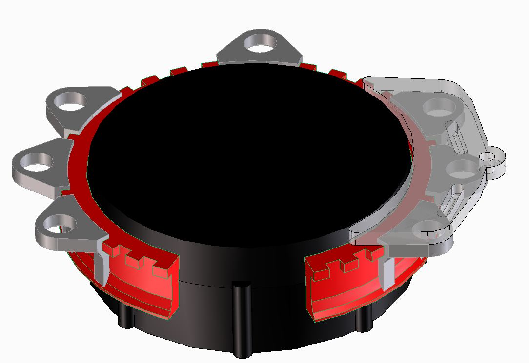

    I was planning a hexagonal arrangement: 3 pipes each side of the lens, plus maybe routing the focus lamp light to a seventh. Plus if I get creative with my collar and the lightpipe clamps, I could group them together behind diffusers (you can print transparent ABS now too) or allow the user to move them wherever they wanted. Current CAD model (the black central part is the solid of the Ikelite port outline, only one diffuser currently shown at right) is attached. One of the things I'm a bit uncertain of is if I want to risk having the diffusers stand a little 'above' the port tip. Too far forward and they'll light up the port face itself and reduce contrast. Too far back and you get port outline shadows again. The Sage fiberoptic assembly just ends in the individual fibers well in front of the port face, but provides some adjustment. Not sure I want to go to all the trouble of having thumbscrews etc. to allow that.
