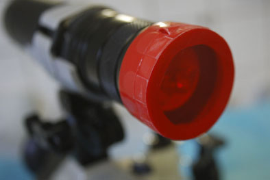

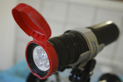

  2. I don't have a Sola but just as an idea:
    I made a simple red filter from the lid of a ketchup bottle that happened to fit tight on my Dive Rite light. I drilled out the centers of the lid and glued red transparent acetate film (available in hobby stores) to the top part.
    Best regards,
    --Rob
