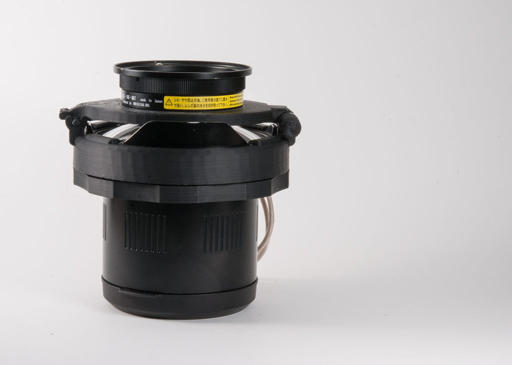

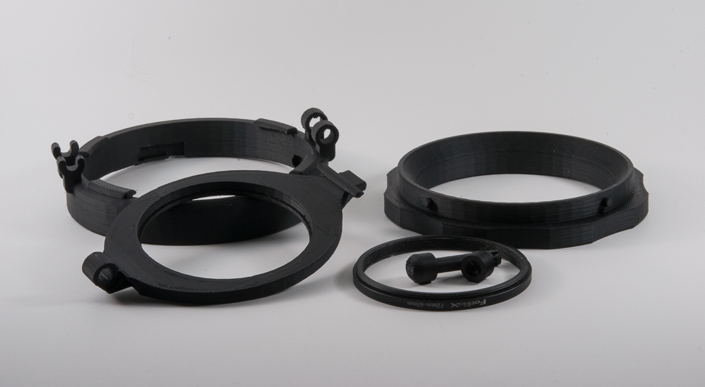

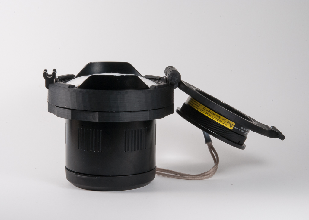

  1. I have a Nauticam housing for my Olympus E-PL3. Recently, I have been mainly using a 4" wide-angle port, as it fits both the 12-50mm (multipurpose) and the 60mm (macro!) lenses as well as the 9-18mm (wide-angle) lens I originally bought it for. When using it with these newer lens, I wanted to add wet diopter. Recently, Nauticam came out with a product for this purpose (http://uw-foto.ch/im...ages/2484_1.jpg) , but I felt that shelling 220$ was a bit too much. Designing & printing my own solution was much more fun.
    The final product is completely made of ABS, except for a single 72-67 step-down ring that provided the filter thread. Unlike the commercial solution, the "base" is not held by screws, but rather by a twist mechanism that locks it into place. It is slightly bulkier than the metal version, but works well. The ABS construction was surprisingly solid, and unlike the metal flip ring (which is heavy) this gadget has slightly positive buoyancy. All by all, after about 12 dives with it I am very happy.
    The design can be found here - 67mm frame holder for Nauticam 4 inch wide angle port by nirfriedman - Thingiverse
    If there is interest I can also upload it to shapeways and then you could order the printed version directly.
    Happy Diving,
    Nir

  11. Very nice job. Are the hinging rings printed separately and glued on to the main holder? I only ask because with my printer the 'within layer' strength is far greater than the 'between layer' strength, so any circular holes are best printed with the axis vertical to prevent them fracturing.
    You do some great engineering! My soon to be posted Ringflash looks hideous by comparison. ;)
  12. Very nice job. Are the hinging rings printed separately and glued on to the main holder? I only ask because with my printer the 'within layer' strength is far greater than the 'between layer' strength, so any circular holes are best printed with the axis vertical to prevent them fracturing.
    Thanks.
    The hinge rings are printed with the main holder. My printer can do this type of prints without problems (it prints removable support structure).
  13. Hello Nir, the reason I am asking is because the 9mm is very useful UW but the 18mm is a middle ground that I could use if I could get close enough and I can't. It will not focus closer than 10 or 15 cm from the dome (focus distance from sensor is stated at 25cm).
    But if I had a diopter in front of it (at 18mm ... not 12mm) I could use the combination for some closer shots.
    I would try it myself but I do not have an adapter like yours or a diopter lens like yours. Maybe if you find out at what focal length the 12-50 lens start vignetting UW it will give me an idea... smile.png
    Thanks!
    I did try to see where it vignettes with a 67mm ring and the reality is that with 18mm still vignettes badly (and that's without a lens just the 67mm frame!!).
    It should not vignette from about 25mm and up. I have not tried as I have to disassemble the 12-50mm from the Nauticam gear (always afraid to lose all those little screws).
    The issue is that the glass port sits way past the lens. Not sure why they designed it like that (maybe designed for Sony lens first?) or just because the center of focus is optimal at that distance, but the 9-18mm lens is back almost 2cm from the glass...
