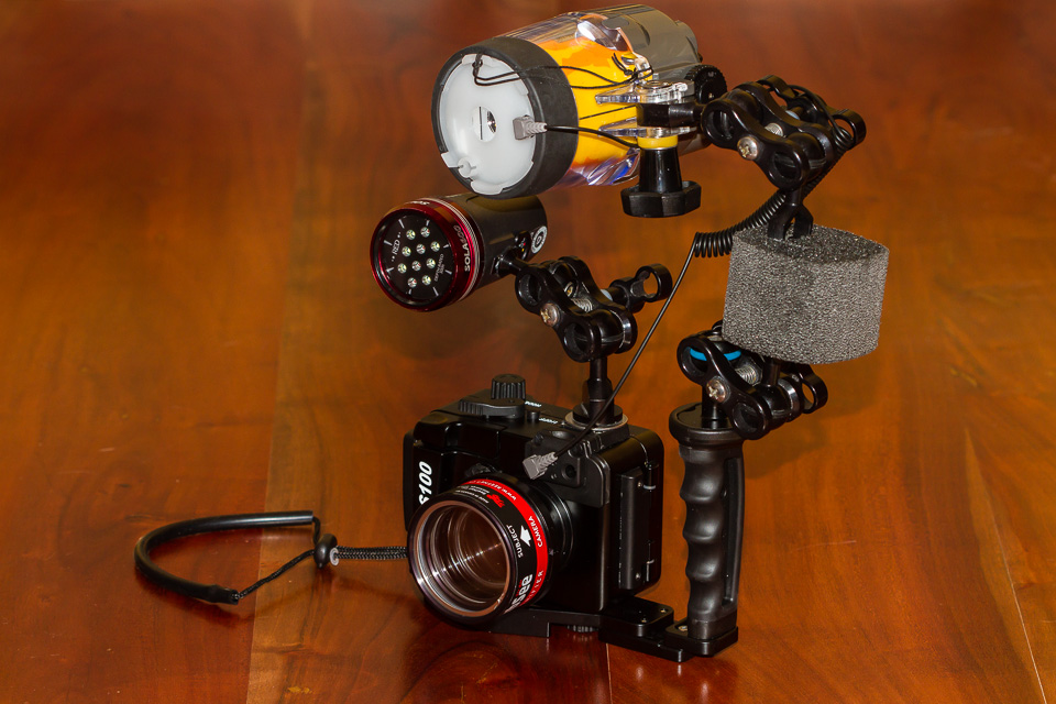

    I think your idea makes good sense. I have been setting up S100 and doing a fair amount of practice with different configurations of focus lights and strobes. I tried using a older Sea & Sea 110 and like you I found the camera really needs a focus light to do macro well. I added one of my Sola 600s to the rig using a triple clamp to hold both the strobe arm and the focus light. It worked but I found it to be very unbalanced and hard to hold comfortably. I purchased a Nauticam Flexitray tray and left side handle to use with my FIX housing and love the combination. The Flexitray lets you adjust the handle distance from the housing. They also make a non adjustable version for a little less money but I like the versatility and my wife will be the primary user and with her smaller hands I wanted the adjustable version. ULCS also makes a handle and tray that would work well too. I have the strobe ULCS arm attached to a Nauticam mounting ball on the handle and it's very comfortable to use. I have the Sola mounted to the cold shoe mount as you suggested. I haven't had the rig in the ocean yet but a couple of practice sessions in the pool have made a believer out of me. This setup as configured would not do TTL because of the older strobe but I'm sort of old school anyway. It would really be slick with a new YS-D1 or one of the TTL Inon units.
    I'm using a Subsee +5 which attaches directly onto the FIX supplied 67mm thread so its very easy to mount. My initial tests have shown that the rig focuses very quickly and the combination has really impressed be with the possibilities. I'll post some images tomorrow of the macro capability. Here is a shot of the current setup. I'm sure others here have more real ocean experience and will chime in.
    You did a great job with the onboard flash, definitely time to get that strobe. (I'm very jealous that you got to swim with the threshers. ;-)

    I tried using the 3-way clamp and it will work but I found it very clumsy to use in practice. The problem is that when you must loosen the clamp to adjust the strobe, the focus light is also now loose and you have to find a way to hold and position two things in one hand while tightening with the other. In practise it's just a pain to use.

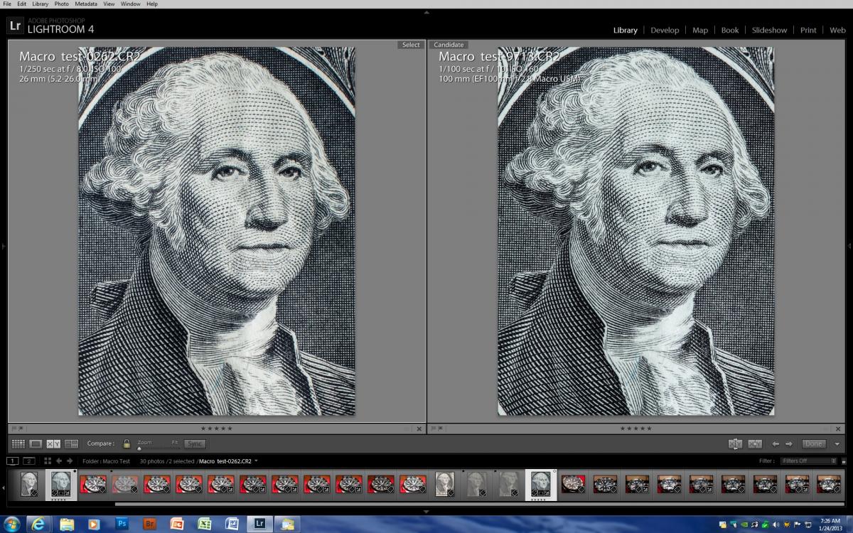

    In practise I prefer the Subsee for it's optical quality. Here is a screenshot of two images side by side while testing the subsee +5 and S100 combination using the setup pictured above. The one on the left is using the S100 and the Subsee +5, the one on the right is my Canon 7D using the 100mm macro lens, known to be one of the sharpest macro lenses available for any DSLR. The image is from the center of a US dollar bill and is 36mm by 24mm so as close to a 1 to 1 full frame equivilent image as I could do. Even pixel peeping at 2:1 it's very hard for me to tell the difference.
