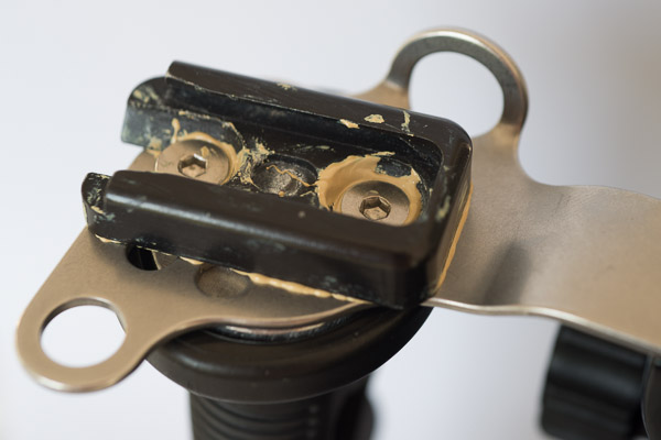

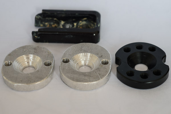

    I don’t like having balls sticking out of my housing; they are slow to disconnect and often make the housing larger than it need be. I like flat dovetails parallel with the film plane, probably a hang-up from using Oceanic flash arm plates many years ago. The aluminium plates on top of the Nauticam handles don’t have holes where I need. Last housing, I had the dimples each side of the 6mm aluminium plate welded up, and new holes drilled and tapped M5 x .8 for the dovetail screws. Then, I made stainless steel support plates to go between the housing and the handles because I could have them made here for a fraction of the retail price. The new housing came with these plates. This time, rather than have the dimples filled with weld metal, I just made new handle top plates out of some marine grade 6mm aluminium plate and drilled the three holes in each that were required. The small holes are tapped M5 x .8.
    The whole assembly was put together with plenty of Duralac. My thinking is this; anywhere that seawater can lodge, I want filled with Duralac or grease before I take the housing underwater. Rinsing is all very well, but not having salt on sensitive parts at all is best.

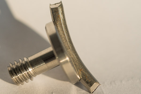

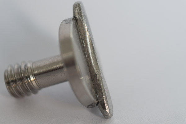

    Having bought a new housing, I have no coins left for securing the camera to the tray. Last housing, I filed a bit of stainless to fit as a handle in the camera securing screw. Normally I would silver solder it to the screw, but I was lazy and superglued it in position. This worked just fine! One trick is to clean both parts with abrasive paper and soap (not detergent); traces of remaining soap helps to polymerise the cyanoacrylate. This time, I bought a stainless steel TIG rod, 3.2mm, bent the end to roughly the right curvature (to fit the curved slot in the camera screw), flattened it a bit with a hammer so it was a good fit in the screw, then cut and filed it to reduce the profile. You may have to lift it a little to get the tray in with no camera, but it’s infinitely preferable to having to borrow a coin… The indignity!
