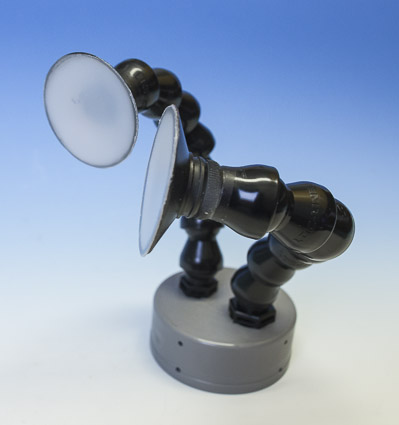

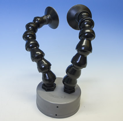

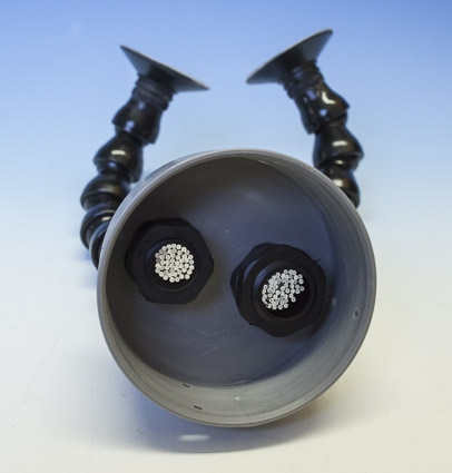

  1. Hi all,
    Just wanted to show a fibersnoot I built over one weekend, fairly simple project and made to fit my Sea&Sea YS90 strobe. Materials I used are two loc-line arms (1/2"), a plastic cap (8 cm diameter) and about 50 feet of 1,5 mm fiber. The miniature softboxes were made of the top of two hair gel tubes with the front cut from a plastic milk bottle. I'll post some pics as soon as it gets wet.
    Best regards,
    --Rob
  2. Hi Rob,
    Very cool project. I had a similar one but with less fibers. For the summer I'm planning to make a bigger one like yours (maybe with 3 arms). I had difficulties to find a proper nut for fixing the screw part of the loc-line. (It's not standard in Germany) Can you tell me your source.
    Do you have good on-line ordering option (in Europe) for Loc-line??
    What kind of cap did you use?
    Many thanks in advance
    Marcell
  3. Hi Marcell,
    I looked for Loc-Line in Europe, but eventually I bought it directly from ModularHose.com Good service, very responsive to some questions I had. Shipping rates are negotiable, too.
    The parts I used were the 1/2" sample kit (product nr 50813) and two types of nylon locknuts: 3/8" NPT (52604) and 1/2" NPT (52605). You have to order these separately as these locknuts are not included in the sample kit.
    The cap is from the plumbing department in a hardware store.
    Here are some snapshots I just took to see the effect. (uncropped)

  6. But I wouldn't call it snoot, because it has no snoot effect (you may change the diffusor to a nozzle to get snoot effect). You split the light in an an easy to adjust way. It's like a twin flash.
    I will make the arms a bit longer to be able to do some side lighting.
