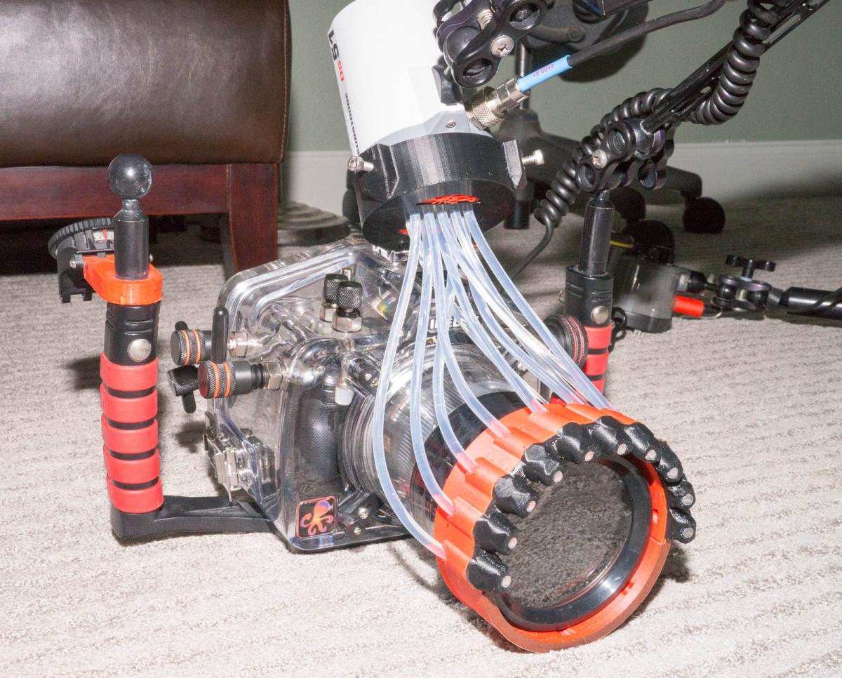

  1. Well, first draft is finally finished.

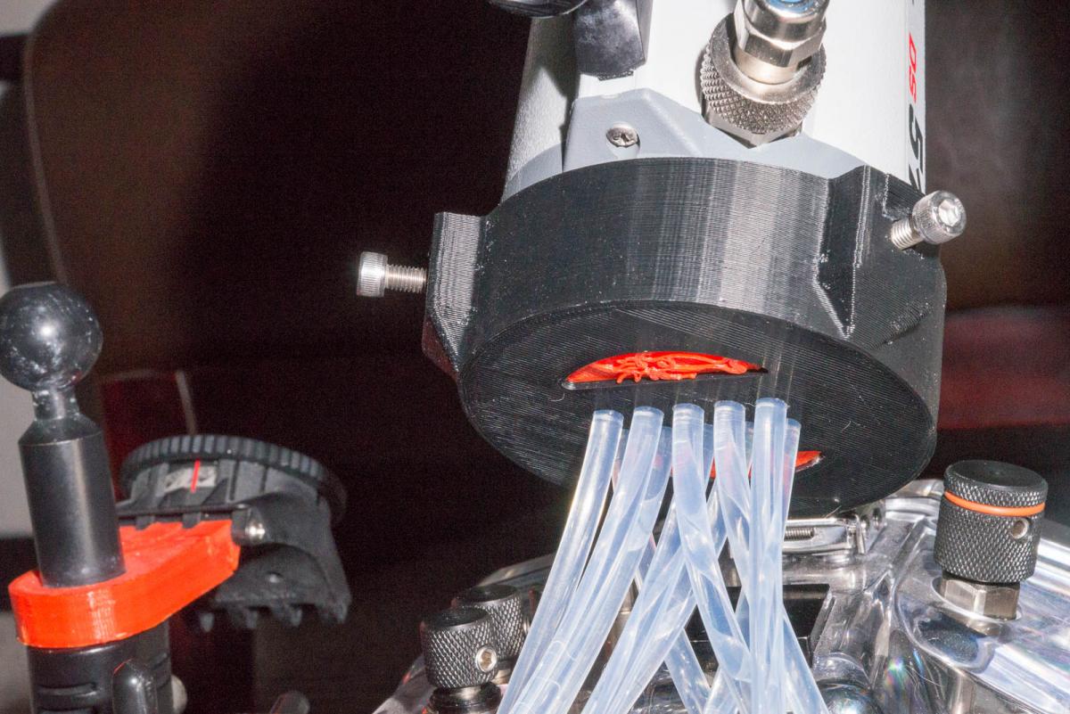

    Dropped down from the 10.5mm lightpipes (the focus lamp pipe) to 5.6mm for the strobe light carriers...8 or 9 10.5mm pipes were too stiff. 8 pipes each lamp off the z240 for 16 total. 3D printed the 'cuff' for the port end and the strobe face cover and pipe mount. The strobe face cover attaches to the z240 with stainless hardware using the same threaded holes as the diffuser that comes with the strobe.
    This might almost be too much light. Shots at 1/160th, F10-12, ISO400, and the strobe set at minimum manual setting (EV -6.0, 1/64th of full dump) are about as brightly lit as I think I'd want in a dark room. I actually have to use the focus lamp in that condition*. That leaves plenty of headroom for even narrower apertures and/or lower ISOs.

    The actual 3D print design is fairly easy after the design, aside from things you probably already know about (dinking around with settings to get internal holes the dimension you want, e.g. for me a 5.6mm fiber fit in a hole 'designed at' 6mm since its really being printed as an inscribed polygon, and there's some tolerance as the plastic squishes together). The strobe faceplate just holds the fibers and provides alignment to mate them up directly to the flash tubes (and focus lamp), and uses the same threaded holes that the z240's diffuser would for some stainless attach hardware. The port section is just most of a ring with the fiber supports printed separately and fused on (it may not be obvious from pictures, but the fibers are angled inward about 15-18 degrees from 'parallel' to the lens axis). It's inner face (not visible) has notches in it that match the ridges on the perimeter of the Ikelite port, which keeps it from rotating (and means you want the port oriented right, but that's just friction on a greased o-ring to twist gently at the surface before it's under pressure). There's no fancy 'lensing' at the fiber tips, I just cut them off as cleanly as I could with a good sharp razor knife. My earlier designs considered an actual physical diffuser (and I even bought clear printable plastic to make it) but as the process went on it became clear it wasn't necessary.

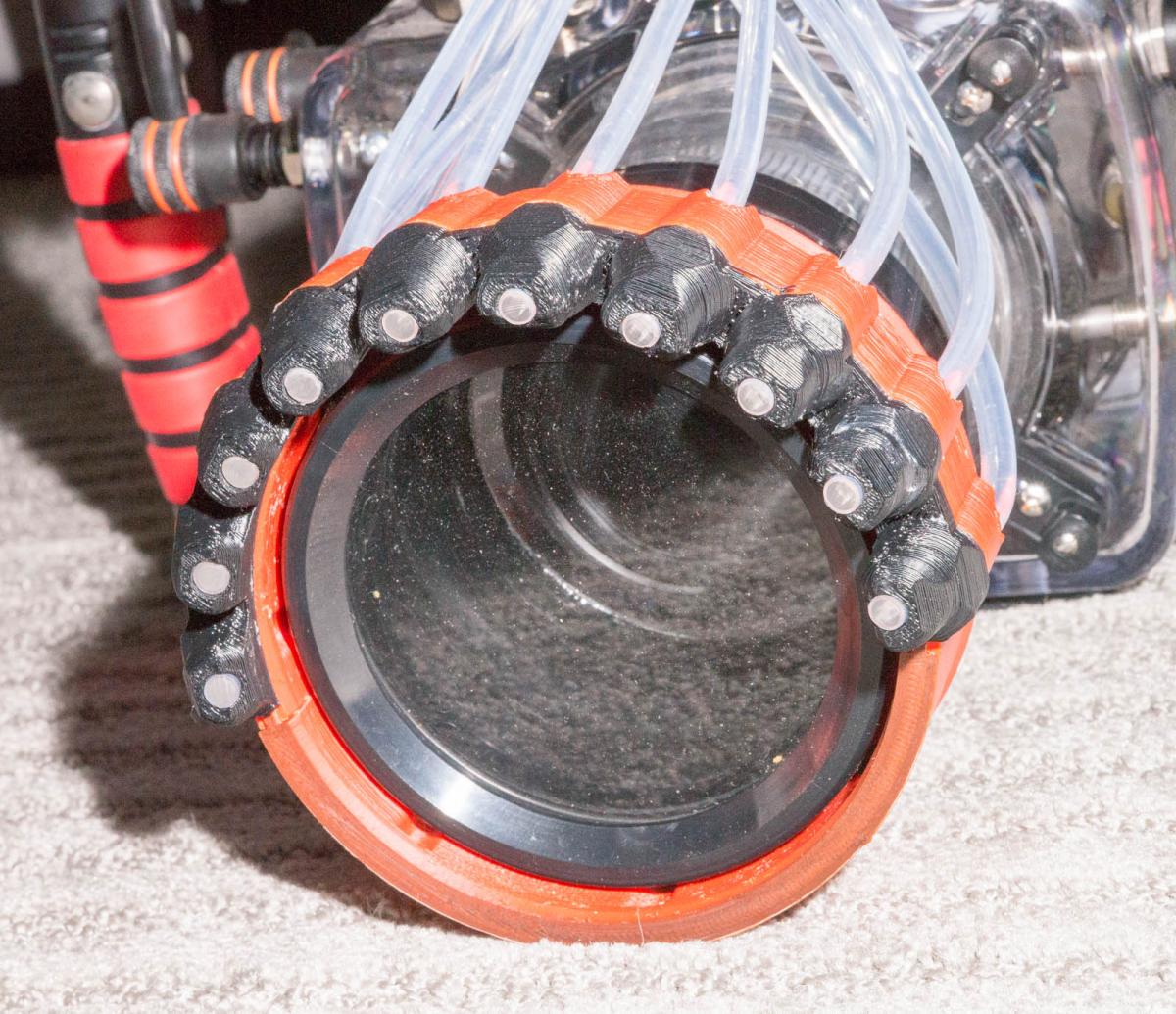

  6. ....and, to necro another post and temporarily rule the DIY forum (yaaaay!), I looked back at this and saw I promised pics of the 2nd generation flash arrangement.
    So, here they are. Basically the ring around the flat port, the purchased lightpipes, and the faceplate over the strobe. Just need to angle the strobe with a couple arm segments so you're not putting too much sideways 'pull' on the port with the lightpipes to risk a leak near the surface.
  7. Can you say a word or two on these "lightpipes"?
  8. It's just fat fiber optic cable. Marketed as side or end glow...but the only difference is black jacketing. Both carry light axially.
    http://www.wiedamark.com/fiberopticsolidcore.aspx
    (and yes, you can use it in a snoot)
