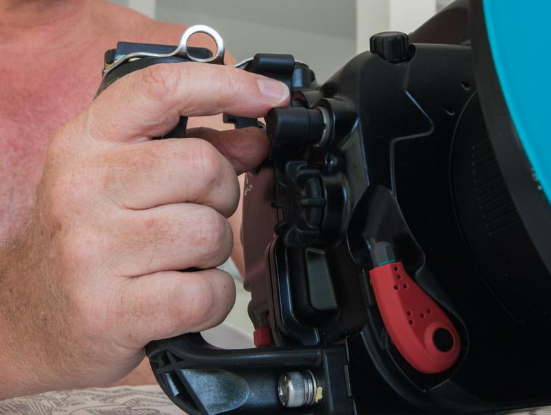

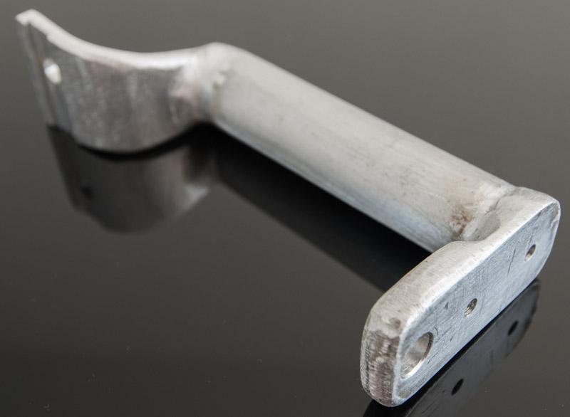

  1. For my hands, the Nauticam D800 housing handles are too far
    from the housing, and my index finger rests too low on the shutter release for
    comfortable use. For people with smaller hands, like my wife, the problem is
    worse.

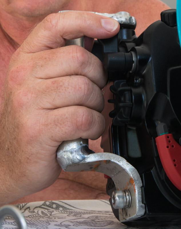

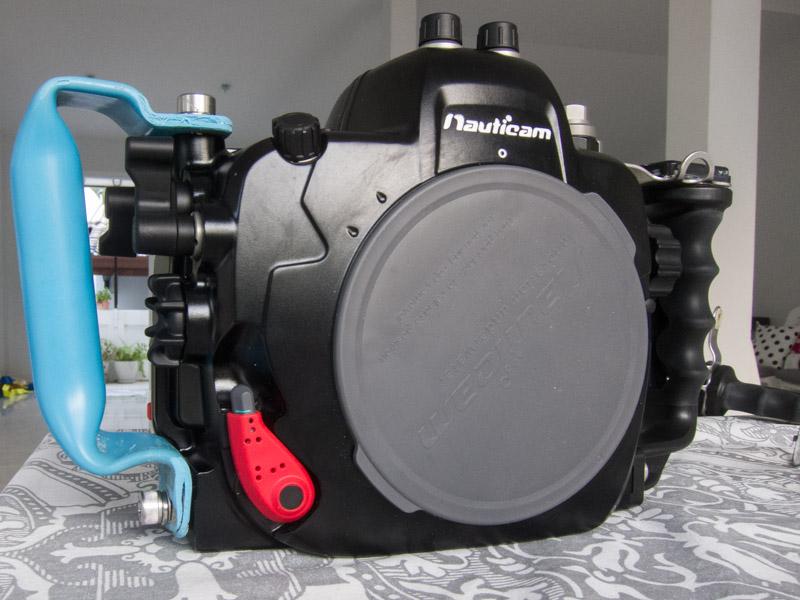

    My first modified handle was flattened and bent PVC plumbing
    pipe, which was sinfully ugly, but gave some indication where the new handle
    should lie in relation to the housing. I rigged up a temporary handle with
    dowel and an adjustable plate, so I could move things around till it felt
    comfortable and still left access to the exposure compensation control with my
    thumb.
    Here's pictures of the original handle, the PVC monstrosity and the new aluminium handle.
    post-23126-0-54787900-1361293710_thumb.jpgpost-23126-0-92663800-1361293728_thumb.jpgpost-23126-0-78457500-1361293744_thumb.jpg

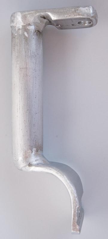

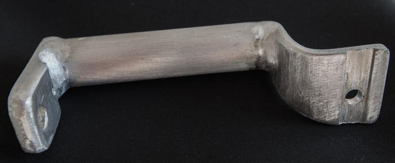

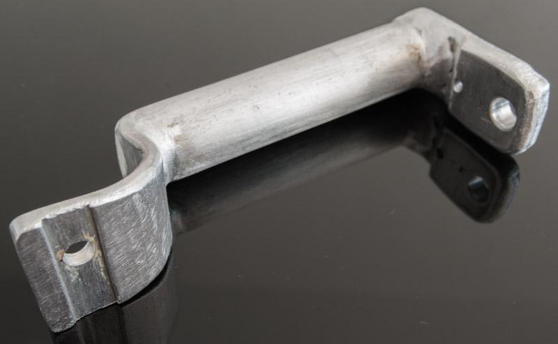

    I cut and shaped the parts with hand-tools then had them TIG
    welded. The dovetail plate for the flash arms is held with 5mm machine screws
    on top. Anodising would improve the appearance, but the aluminium is
    marine-grade. The new handle is little different in weight from the original
    and reduces the overall housing width by 20mm.
    post-23126-0-91257300-1361293786_thumb.jpgpost-23126-0-09720500-1361293799_thumb.jpgpost-23126-0-53287400-1361293815_thumb.jpgpost-23126-0-24436600-1361293829_thumb.jpg
    If I had to use gloves this new handle would be unusable,
    but I hope never to be in water cold enough to require them…

    Rather than anodising have you thought of trying a thick powder coating - whatever marine grade aluminium is you may still suffer from electrolytic corrosion if its bolted directly onto the housing. Powder coating might well be a cheap and effective solution.
  7. Good idea Paul, especially as there doesn't seem to be an anodiser in Phuket. I slathered Duralac on the bits and bolts when I put it together, so I am not very concerned about corrosion. Yachts of this stuff have bare topsides. Hopefully the Nauticam is machined out of a block of 5000 or 6000 series alloy, so it shouldn't be an issue. I will keep an eye on it anyway, I don't mind the handle corroding but I don't want corrosion on the housing!

  10. Do you really shoot with your hand in dorsiflexion (the wrist bent inwards, the fingers slanted away from the housing)? It looks very awkward and uncomfortable...
