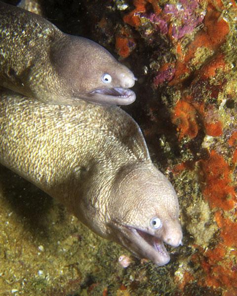

    I would like you to give me feedback on my images, i'll post a few in this thread which i made with my newly purchased Ikelite ds-160 strobe.
    1st:

    I would like you to comment on (some) of these pictures i've taken, and what i should or could improve about them.

  2. HI Max, welcome to Wetpixel!
    I like the images you chose to post, they are an interesting mix. I can tell you what I would think about if presented with these same opportunities, whether or not my recommendations make sense to you is your call. ;-)
    The first image has tons of potential, multiples are almost always more interesting than singles. The orange background is a nice opportunity too. I would have tried to get closer and fill the frame with the morays and just the orange negative space. The brown doesnt do much for me. There are lots of options for the light direction here. It would have been a lot of fun to play with and try different alternatives for strobe angle. Definitely closer though.

    Thank you for the feedback Steve,
    To be honest, the 3 i took with the strobe, were my first shots ever to be taken with strobes.
    The 3 strobe shots were all taken on my vacation in Sri Lanka without practicing back home in Holland.
    I only made 1 dive there because i noticed in the 1st dive that the dive guide had no eye for safety whatsoever, so after the dive i told him i did not want to continue diving with him.
    There was a very strong current washing over the dive site, so it was hard to stay in one place without having reefhooks, this resulted in me only taking 8 pictures during the whole dive.
    so the 3 pictures you see are almost half of all the pics taken. I do have one more pic of the 2 White-eyed morays from a different perspective.
