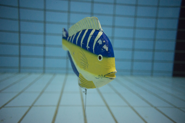

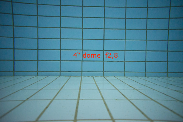

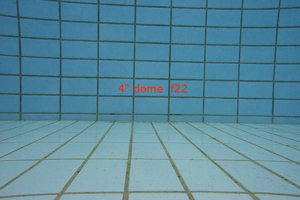

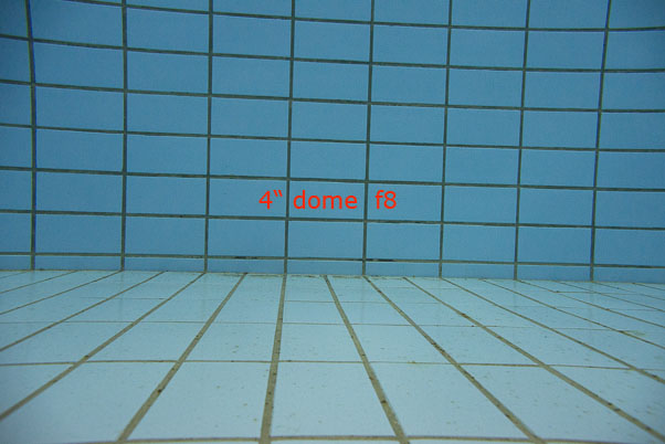

  9. Here are the test shots I promised. It's the Sigma 24mm 2.8 with a +4 diopter, behind the Subal 4" compact dome port. Just about usable down to f8, any wider and corner unsharpness and vignetting increase dramatically.
    However, when you're shooting close focus wide angle, it's a different issue (my static fish @ f2.8)
