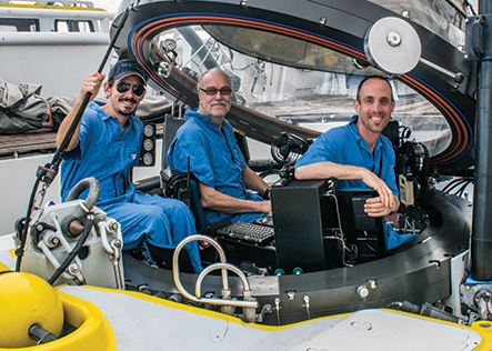

  5. I thought that the trip in the DeepSee was a great once-in-a-lifetime experience. However, the only successful pictures I got with the camera dry inside the sub with me was of my fellow passengers! You need to position the camera lens node at the correct spot inside the dome to get good images and as anyone with an underwater camera will tell you on looking at the dome of the sub, that will leave the camera looking directly upwards. You would need to contact Avi or Schmolic at understatement.com about the possibility of mounting your camera in its own housing on the outside of the sub.

    As John says, you'll have to apply dome dynamics dynamically. I used a 70-200, 16-35 and 24-70 on my dives. I put a 12/25mm extension tube on the 70-200 so it could focus closer on the virtual image. Just don't go higher than f13 since the diffraction is mush detail A diopter can be used as well. I never recorded exactly what strength diopter I used for the telephoto but you'll want that to shoot the smaller fish like the jello nose which are usually more downward between your legs through the dome. I can't remember the dome specs now but if you ask Schmulik, Nico or Avi, they'll tell you.
    You may also have to do some yoga poses to shoot wide angle and feel free to get into the center space. Use the 5D3 since the extra resolution will help when you have to shrink down. Use the 1Dx with the 70-200 to catch the smaller fish and the 5D3 with the 24-70. The Pricklies I had weren't so shy but subsequent dives, they stayed a bit further away, so the 16-35 was a bit too wide.

    3) Photographing from the submersible.
    It is not possible to get to the optical centre of the acrylic dome as it is blocked by the control panel. This problem can be ameliorated by using: a small camera, a right angle viewfinder, a remote video screen with live view. Still reasonably sharp images were obtained with a full frame zoom lens up to 70mm , although the images were not as sharp as from the normal underwater housings. A +1 dioptre correcting lens did not improve the image quality. I could not find a sweet spot photographing from an arbitrary location, due to local variations in the acrylic refractive index, probably caused by stress and age.
    The DeepSee has external arm, which can be used as a normal underwater housing with flash, but this is at the passenger's expense. At present only affordable by the likes of the BBC or National Geographic.
