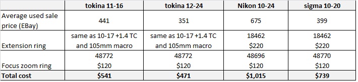

  7. Thanks for the info everyone. It's just dawned on me that the the "true" cost of using the lens underwater includes the cost of any extensions/zoom gears I also have to buy (Aquatica housing). It looks like if I stay with tokina I'll be able to use the extension for my 10-17.
    I'm going to look at the lenses you have all recommended and check out both the cost of the lens plus any extensions etc I aready have. I'll post the analysis here in case anyone is interested.

  8. As per my earlier post here is a quick analysis of the real cost of getting the different lens options operational.
    One of the Tokina lenses makes sense from a $ perspective (and less gear to carry), unless the sigma is a lot better. Which tokina would you get? I have both 8in and 4 in domes.
