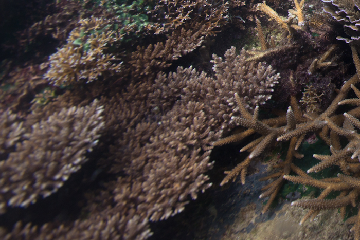

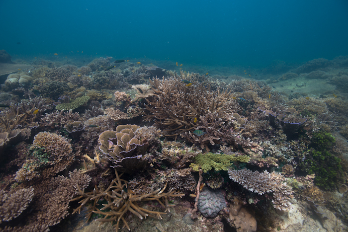

    The 2 images attached: Nikon 17-35mm, Nauticam 9" optical glass dome & 70mm ext ring, 17mm, 1/200s, f9, ISO160, natural light. (The 2nd image shows the blur in the bottom-left corner of the 1st image).

    I am using a d800 in a Nauticam with the 16-35 behind the 9" glass dome. I find this setup works well, but you still need to stop down to get the best results.
    Have you tried shooting at say f 11 ?
  3. I use the 15mm Sigma and get pictures sharp as a tack from corner to corner with both the Hugyfot acrylic dome and the Sea & Sea optical glass dome. It must be lens related.
  4. Yo Chris
    The Tokina +1.4x is still too wide for a D800. You need to get it to 11mm for no vignetting.
    As for the 17-35, if I remember it had a bit of field curvature so try going to f11 at least.

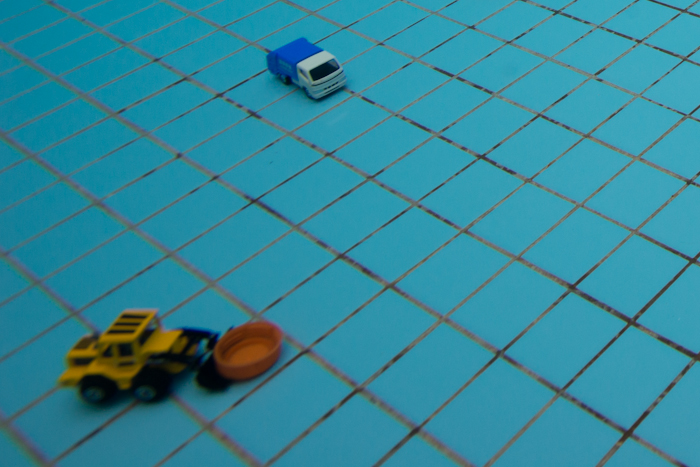

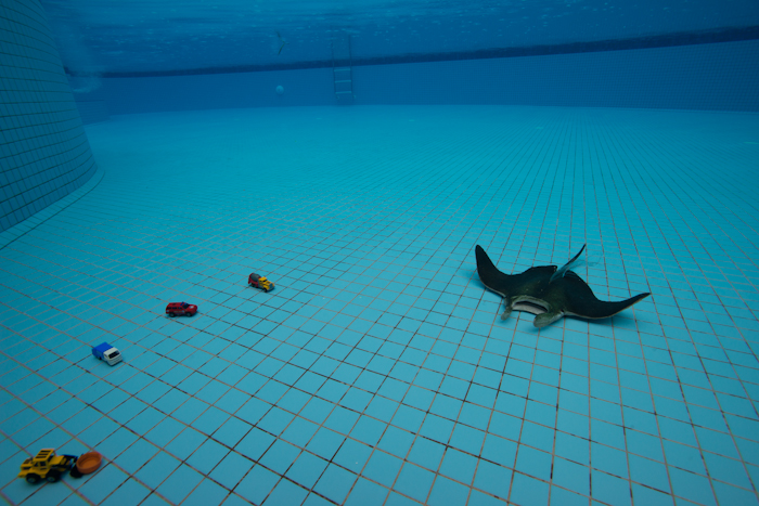

  10. Here's how it looks in the pool: 1/125s, f11, ISO250

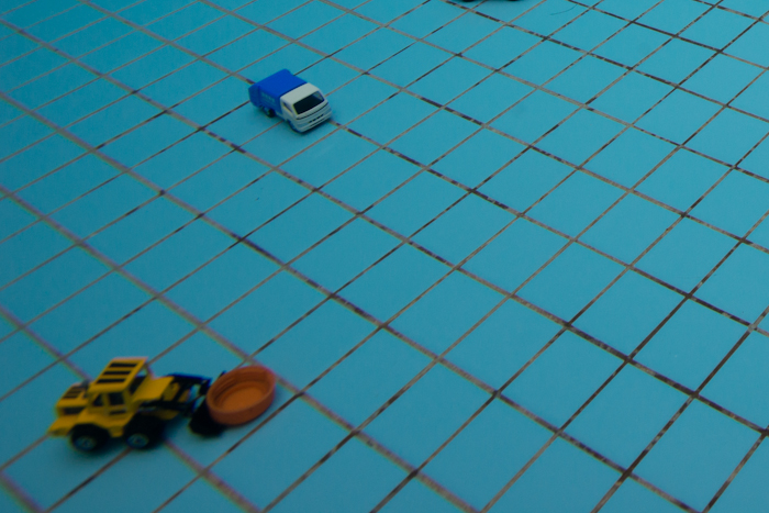

  11. And here's 2 more shots at f13 with the nikon 17-35mm at 17mm 1/125 ISO250.
