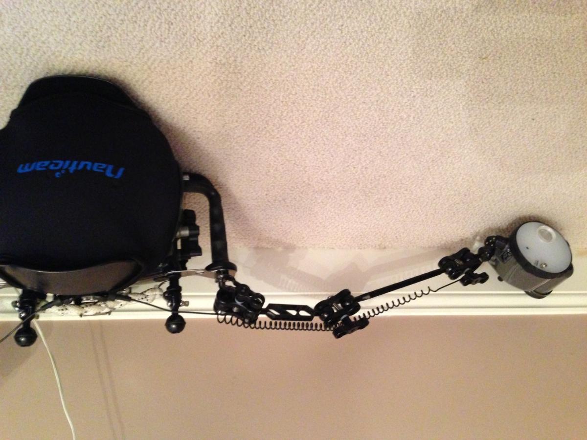

  13. Steve, I also have a 5 and 8 and the cables are long enough for me to stretch the arms fully (please excuse the upside down image - hopefully you get the point) :)
