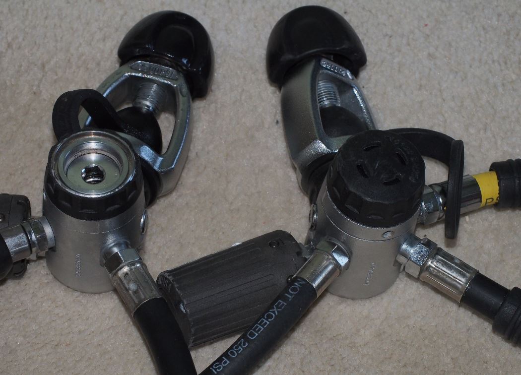

  1. One dive on my last trip got a bit more exciting than intended. 24 minutes into the dive at 18m depth my first stage blew off its end cap and whatever is supposed to be behind it. The result, a pandemonium of noise and air bubbles. My buddy had already been alerted by the noise and we weren't too far apart. I gave the out-of-air sign, although it must have been pretty obvious, and her octopus got its first life action. After I closed my main valve to get rid off the noise and conserve the remaining air in the tank, we ascended to 5m and buddy-breathed the 15 minute swim back to the exit point.
    This is something you always hear about and it was part of the solo diver training I took last year. But in the end you never know how you respond when it really happens. In this case all other conditions were favorable. Good visibility, no current, familiar dive site, 40 dives in the preceding days, and an experienced buddy within short distance. But it is a good reminder to be trained, prepared, and equipped to deal with whatever situation a dive throws at you.
    Here is a picture of the regulator and its intact sibling. It was serviced just before the trip but I'm now looking for a new reg and a new dive shop to take care of it. The escaping high-pressure also broke the octopus but I hope that can be fixed.

  2. This is why the only person who services my regulator is me :) Over the last 15 years of working full-time in resorts, 95% of the time someone has a problem with their equipment is just after they've had it serviced. There are undoubtedly good technicians out there, but there are too many to whom it is just another job, fixing some bit of equipment and not checking thoroughly...they forget that this equipment saves our lives every time we take a breath!

  3. I just had a similar experience, although just before a dive, where my newly serviced Atomic safe second just ruptured and air just gushed through it. Luckily I am mr redundant and had a manual inflator assembly with me so dive saved. it was just serviced, tested in my garage the week before the dive, all worked. On the boat, kaboom. Took it back to the dive shop and they were so nonchalant about it, "yea, that happens sometimes, an oring occasionally slips out on these after servicing causing the air to gush out....we'll fix it for you". No shit. And bullshit. I call incompetence and ripped them a new one.
    What brand of regulator exploded on you, Bart?

  4. My regulator was an Oceanic gamma 2 paired with a CDX first stage, bought in 2001 or 2002. Doing some internet searching turned up a safety recall for this particular type fo first stage issued in Fall of 2002, with the option for a free fix. I was never informed about this (the reason for the recall was vibrations and noise, not a failure) but when I brought in the reg to the shop that serviced it they told me the safety fix would have been applied the first time the reg was serviced after the recall was issued. I left the reg with them to check out what went wrong. I had one other first stage failure with this reg or its twin but that was less dramatic and happened after surfacing from a dive. I will wait to find out the cause of the failure but am reluctant to put this regulator back into service.
    Bart
