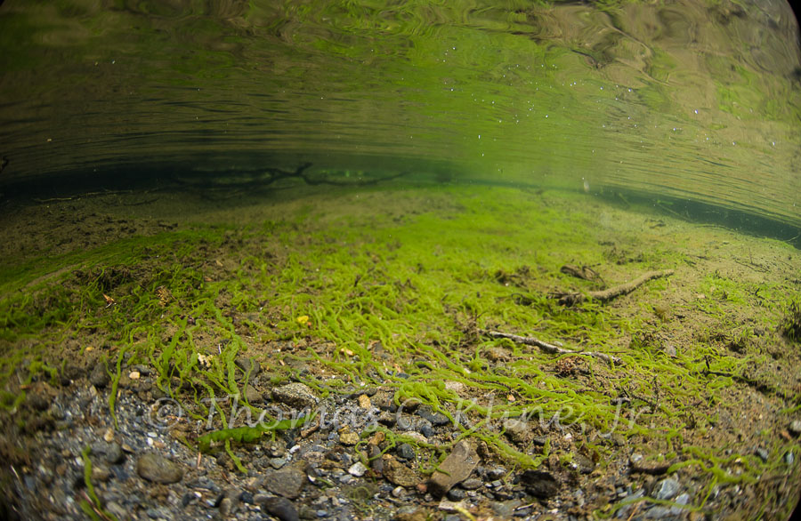

  8. Here is an example of shooting a fisheye lens wide open. In this case a 10.5mm on DX format. Note how the algae in the center foreground is in focus and on the left and right in the background but not the center. This is due to the curved field of the virtual image formed by the dome port.
