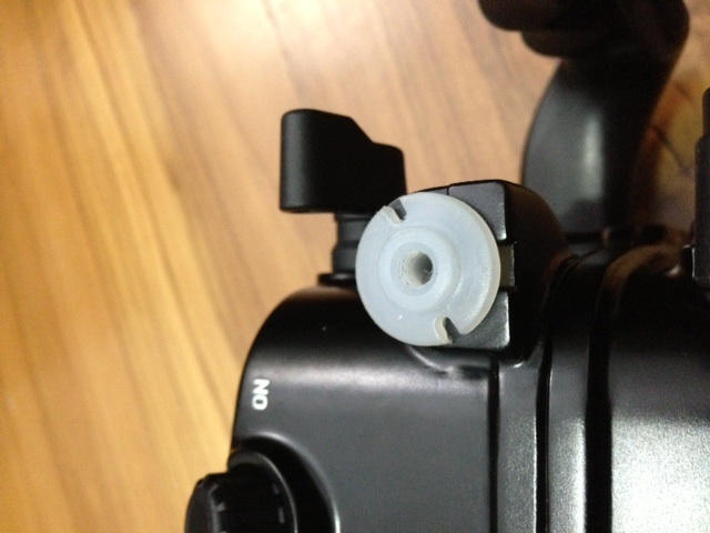

  2. Hi everyone,
    I have another question about the housing. I am trying to mount my focus light on the housing, so I need to add a 1 inch ball. I already have the M10 strobe mounting ball (25221). The question is how do I mount it to the housing? There's a metal plate connecting the handles to the housing for stability. Once I remove this, there is a plastic plug in the hole that I need to use (see picture for the plastic plug). It is lodged in pretty tightly and I cannot seem to remove it. How do I remove this plastic plug? Thank you.

    I tried to use a pair of long nosed pliers to remove the plastic plug on the housing but it is lodged in very tightly. I even broke off a small bit of the plastic plug by applying too much force to the pliers. Any other ideas?

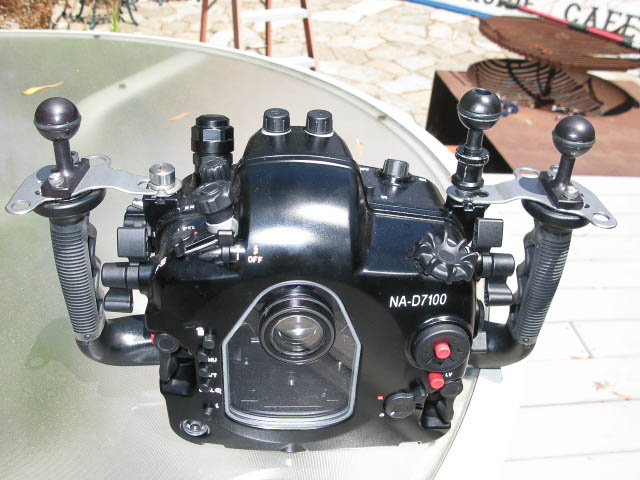

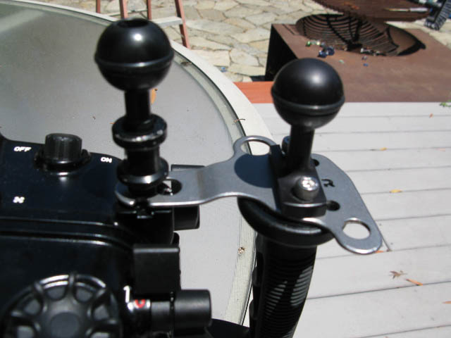

  5. Not sure where the problem lies. Remove stainless screw/bolt that holds bracket to housing and put ball there or get something to mount above handle. Exmples pictured.
    Hope this helps.
    cheers,
    Steve
  6. Eyematey,
    Please see the attached picture. The hole on the housing where the mounting ball is supposed to go is blocked by a white plastic plug that is stuck very tight. I would like to know how to remove it without using brute force as I am afraid to damage the housing. Any help is much appreciated!

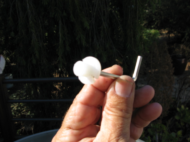

  8. Eyematey,
    Your housing came with a black round tool with two little prongs on it. That little tool is for removing and installing that plastic piece. There is a hole through that tool and you can put an Allen wrench through it to get leverage while GENTLY, and FIRMLY, and SLOWLY turning it.

  9. That sounds right although my housing didn't have that or it was already removed. Spanner wrench would probably work also since its threaded in.

  10. Was wondering what that was. Learn something every day. BTW it takes a 4mm allen key to thread out.

  13. Hi everyone,
    I tried to use an allen key to remove the plastic plug and it did not do the job. The plastic plug is lodged in pretty tightly.
