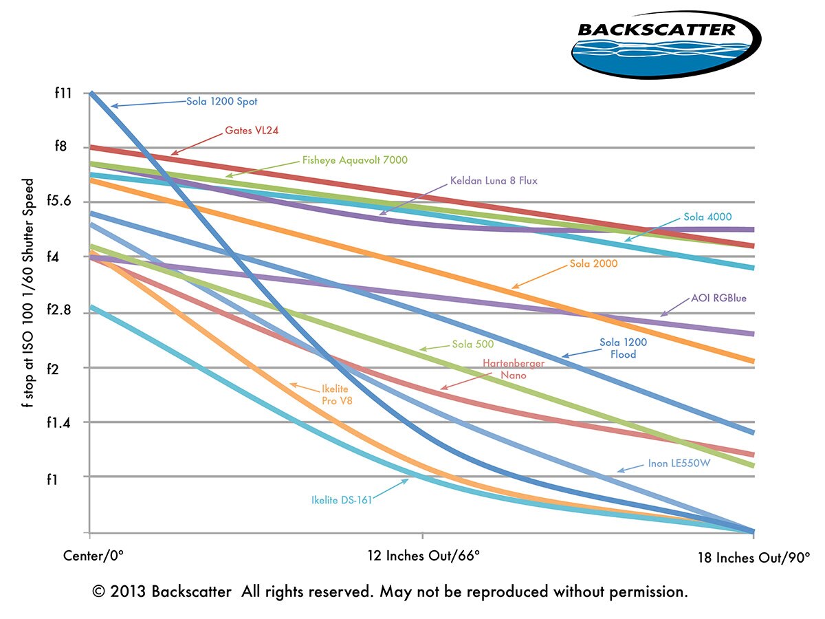

    What kind of coverage do you want? The problem with going with lumens ratings, you sorta don't consider the spread of the beam. A 100° wide 10k lumens will not throw much light further than 1m than a 60° 6k lumen light. But then again you may get that headlights effect if your lens is too wide.
    Here's an illustration (thanks to the guys @ Backscatter for making this chart):
    Backscatter-Video-Light-Testing_Graph_hi
    As you can see, the Aquavolt 7000 is suppose to have 7000lumens to the Sola 4000 lumens, but it's also 115° and the Sola is 80°. Thus the Sola is only about 1/3 stop for being out over 50% less power. If you look at the Keldan, it has 6k lumens @ 90° beam, so it can stay with the Aquavolt. Same for the Gates VL24, which has 6k lumens @ 78°, so it actually is brighter until the narrower beam tapers off.
    I think for wrecks, if you are using a rectilinear lens, 2 narrower beam lights will suffice and you can get longer arms to avoid backscatter. Of course with a fisheye, if you aren't careful you will get the headlights look.
