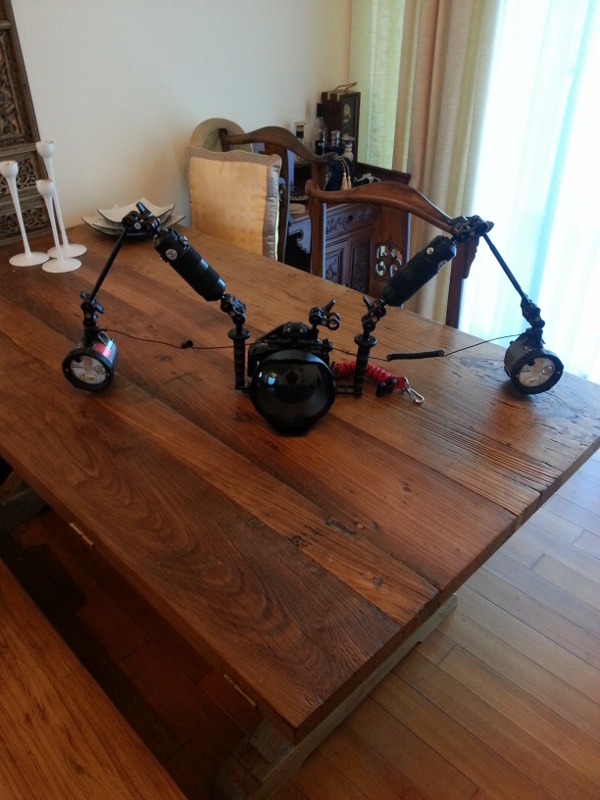

  1. Hi Guys,
    I recently got the attached setup for my underwater camera (Olympus camera, Nauticam housing and Z240 strobes).
    With this configuration I noticed that the handle bars are quite unstable for this setup. As such I am considering adding a bracket of some sort on the top of the two handle bars above the housing to add stiffness to the construction.
    Does anyone know of a bracket for this nauticam setup (the housing and arms are nauticam) that would do the trick? Would I need to make one myself?
    As a secondary question, on land, gravity makes the setup heavy, especially with the strobes apart as in the image. On land this requires the clamps to be tightened quite a bit, to the point that it becomes very hard to adjust the position of the arms. Would this be resolved if I attached the floating arms to the strobes (i.e. swap the arms) making the strobes more floating? Is there another way? (I was told that the dome on this camera makes the housing quite buoyant, which implies that floating arms close to the body is not required, but floating arms close to the strobes may be appreciated...).
    Any advice will be appreciated!
    Thanks!
    K
    PS the stability problem is very similar to the topic described in the following link, except that the solution cannot be implemented wih hthis housing as it only has one ball mount on the housing, not 2
    http://wetpixel.com/forums/index.php?showtopic=42507

  4. I realised this afternoon that the 3-way clamps could do what I want. I'll explore that possibility. It may not seem necessary in water, but forces are still forces, and I feel more comfortable with some stiffness. eliminates vibrations too...

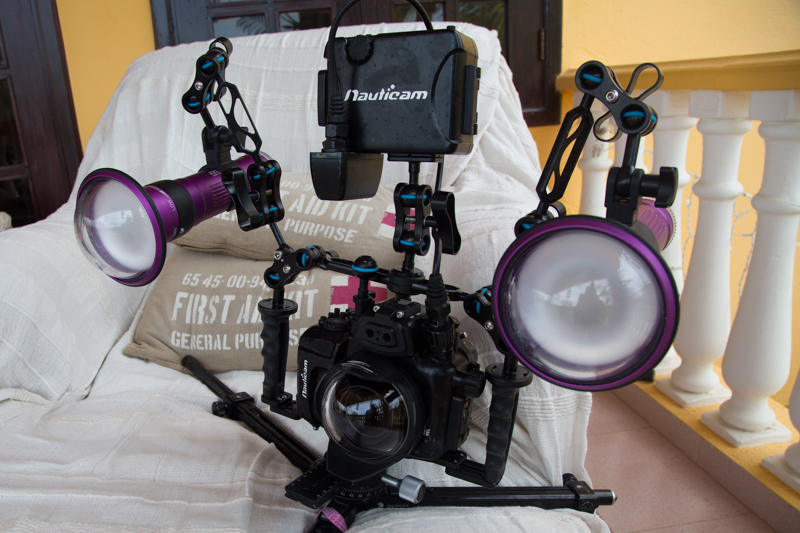

  5. Here's one way to do it:
    Basically it adds a cross bar using the Nauticam multi purpose clamp. This is a GH3 with the large Keldan Luna 8 lights, plus a monitor on top of the crossbar. Very stable… check out my video below that I shot with this this setup. Let me know if you want any more details about how to set this up.
    In regard to your question about needing to tighten the clamps on land, one way to deal with this is to use a lanyard at the top of the triangle, rather than lower. The arms then carry much less weight when you are carrying the rig. The type of clamp you use can also help you in this regard.

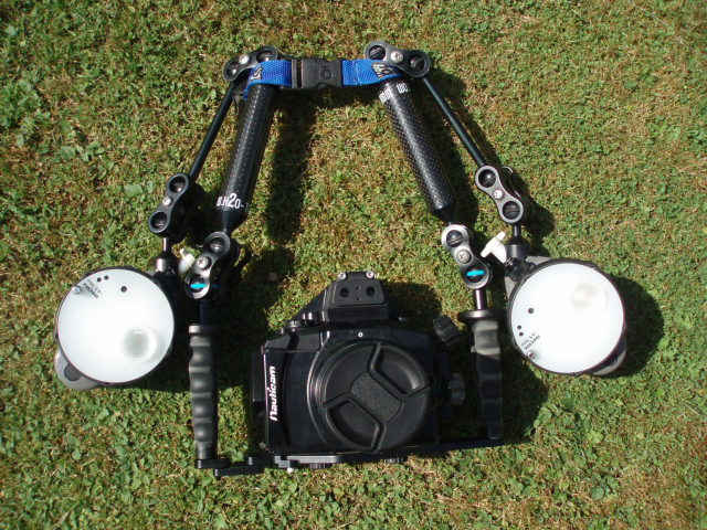

  8. Hi,
    why not keep it super-simple? - This setup has been working for me for many years, even with my heavyweight NikonosRS-Zoom-IkeSS200!
    The OM-D and the Inons are so lightweight - absolutely no problems during the 60+ dives I have been using it up to today. And I personally do not feel that the rig in itself is unstable. Maybe you need to apply some more force when tightening the screws!!! :laugh: ( But remember: After "very tight" comes "very loose"...)
    And, by the way, a very simple solution, cost about 2 US-$, for the replacement of the unusable grey Nauticam port protection: A 77mm lens cap from ebay.
    Greetings,
