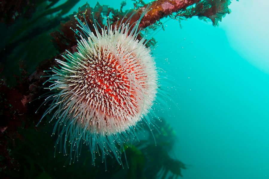

  1. I am having problems understanding this picture of the tentacles of a common urchin. Now, its not the best picture in the world so I'm not looking for critique but rather for help with the technicalities.
    1376479_10151952099139260_428214526_n.jp
    It is taken on a D200 and 60mm with a 36(?I think)mm extension tube. It is a 1 sec exposure at f32 at 100iso.
    I shot f32 to get dof. I shot 100 to get best quality. I shot 1 sec to get green background.
    The strobe (both) was a subtronic with dial set to 4 (1/4?) and as the tentacles were moving, it has done quite a good job of "freezing the action" and giving me sharp tentacles (things that are in focus are not blurred, ya catcha ma drift?)
    My understaning is that one can use strobes as a shutter to freeze action: what are the numbers here? ie at full splat, how long is the light lit in shutter speed terms? is there an equivalency or is it just super fast? How far can you go in freezing stuff that is really small? What use is this idea in a wider context?
    I guess I am just asking for help with the situation: if anyone could point me in the right direction, I would be chuffed to bits.
    Many thanks
    Bob

  2. The strobe is so fast that it really doesn't matter how fast it is.
    Motion blur comes from those parts of the image that are lit by the ambient light, and you can see ghostly blurring: with moving objects it's the principle underlying the use of rear-curtain synchronisation, creating an impression of movement.
    A Subtronic strobe is a big, expensive beast with which to learn the basics...
  3. I seem to recall hearing somewhere that strobes fire a flash of light that is ~1/1000th second long
  4. thanks for your posts guys, input appreciated.
    However, you seem to contradict each other as a strobe "lit" duration of 1/1000 puts it within the shutter speed range? Am I right in thinking my fastest shutter is 1/8000? How do the "lit" durations vary with light emitted strength, ie is 1/64 as marked on strobe equal to 1/1000sec "lit" for eg? Wrong words but you get the drift!
    I think in this photo nothing is lit by ambient, hence no "drag shadows", the only reason for 1 sec is to get green background. I shot rear curtain but think this is a moot point for that reason maybe?

  8. ... you seem to contradict each other as a strobe "lit" duration of 1/1000 puts it within the shutter speed range? Am I right in thinking my fastest shutter is 1/8000? How do the "lit" durations vary with light emitted strength?
    Strobe power is determined by the duration of the flash, except at very low power when the colour of the flash can also change. I can't find the specifications for a Subtronic strobe, but a typical flash's duration is indeed about 500 microseconds to 1millisecond. It takes a typical camera's shutter about 1/200 second to open and close, so faster shutter speeds (where both shutter curtains are moving at the same time) are incompatible with flash photography, as only a band is illuminated. In practice the only things that you can't freeze with a strobe in underwater photography are the strike of a mantis shrimp and the snap of a hungry frogfish's jaws...
    ... you need studio lights and a fast shutter speed or highly specialised and expensive strobe lighting to freeze a hummingbird's wings!

  10. righto, this is not about sync speed: I understand that concept (and have a thousand pictures of black bands to prove the point)!
    Have a look at the picture: the tentacles were waving in a current yet the pigment in the tissues is sharp in the tentacles that are in focus yet the shutter speed is 1sec. In ambient light, this would have been a blurry mess but the strobes have frozen the action.
    I know if I take a picture of a gull on the sea, i need to be in the thousanths shutter speed to freeze water droplets on the birds. I know when to take a picture and when not to if I want to see sharp water droplets.
    What I would like to see and understand is how a strobe does this, if at all. An explanation using Z240 data would be fine as they are the most common strobes..
    so for example, say I was taking a seagull and was wanting to freeze the drops underwater (bear with me) I could use a low strobe light setting (ie fast light burst = fast shutter speed). To get the exposure, I could move the strobes closer to the subject to compensate for the low strobe setting.
    Or is it all just a big box of magicdoodoo where pixies paint delicate waves of fairy dust over nudibranches?
  11. The flash makes a burst of light. Its duration is dependent upon the size of the flashtube and the power output of the flash. For example, I have a studio flash at full-power (2000j) that has a long duration of about 1/150 sec. The duration of a little flashtube at low power is very fast indeed. So as long as the pulse of light can fit into the time the camera shutter is open, it will be effective. I suggest it was so dark that the ambient light on the tentacles was so little as to be negliable. (By the way, Bob, I was just thinking I should get rid of my Subtronic strobes too - if they still work!)

  12. You could recreate this technique on dry land. Find a dark room, set the camera up on a tripod with an exposure of (say) 10 seconds. Trigger by hand a strobe as you walk past (without tripping over the camera - it's dark remember!) the open shutter. Until that burst of light appears - its duration measured in milliseconds - the sensor/film sees and records nothing. The camera records the short burst of light from the strobe and freezes your motion.
    Keep walking and trigger the strobe again and the walker will be recorded twice on the same exposure.

    You aren't making friends by missing the point, you know: the range of flash durations is from, roughly, 250 to 1200 microseconds, corresponding to shutter speeds of about 1/800 to 1/4000 sec.
    http://wetpixel.com/articles/inon-d-2000-s-ttl-official-explanation
    Manipulating the strobe power causes more problems than it solves, largely because macrophotography uses small f-stops and you would have to get prohibitively close at low power.
    In practice, and some of the contributors here have a lot of practice, manipulating the duration of the flash just isn't important in underwater photography, as very little moves so fast that it isn't frozen at 1/600 sec. All strobes are faster than that.
    As has been said above it's the ambient sunlight that blurs most images, and it's the use of that ambient light that defines some of the very best underwater photography.
    The only magicdoodoo in underwater photography is the sense that comes from spending lots and lots of time underwater with a camera, although following the advice of Martin Edge comes a reasonable second...
    ... and the problem with your original image is simply depth of field, as anemones are circular animals and it's almost impossible, when close, to have all of their tentacles at the focal point. It has nothing to do with strobe illumination.
