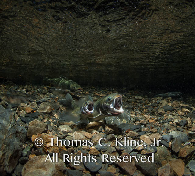

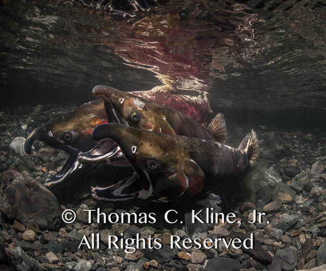

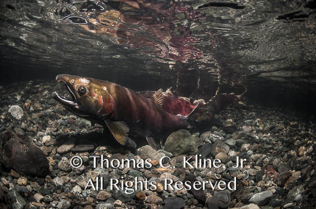

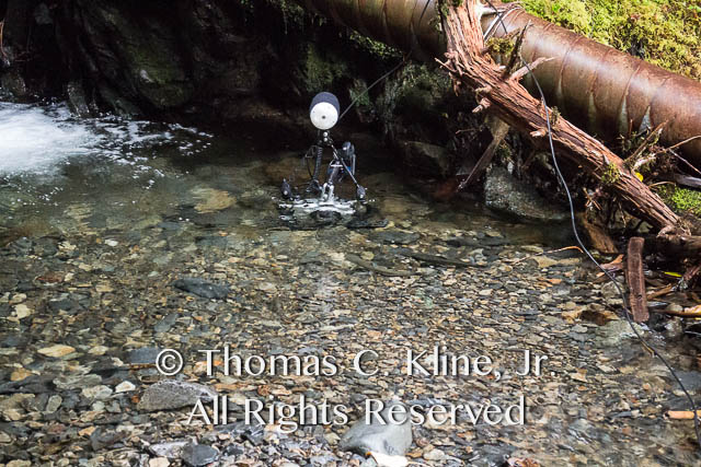

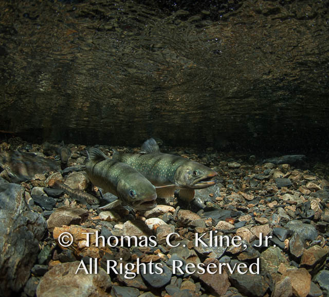

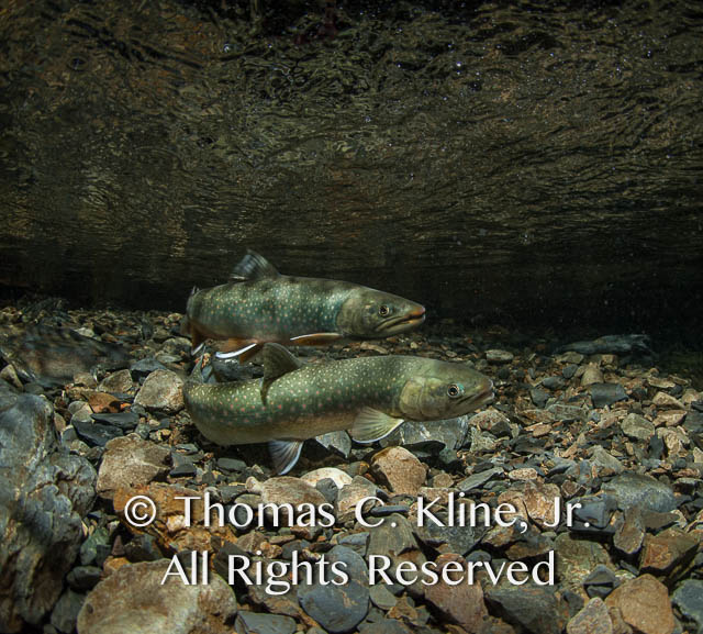

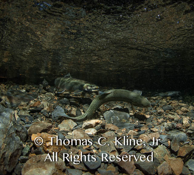

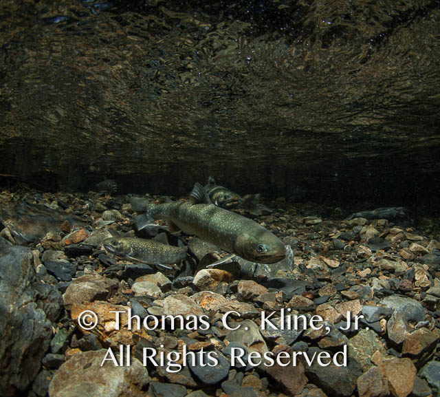

  10. I have some experience with non-diving UW photography shooting fish spawning behavior. This has been done using the Seacam system which has several remote control options. My primary lenses are fisheyes. I use manual exposure and strobe settings but rely on AF, which needs to be fast and work under dim illumination. Batteries need to last for hours. I am posting some recent pix done of Dolly Varden Charr spawning in very shallow water. The smallest ones were about 4"/10cm long, the larger ones about 8-10"/20-15cm long. The set up shot shows some rubbish that was left there in the 1980's. The challenges of this location include stained water (though not as bad as other locations in my area) and air bubbles from a series of waterfalls.
    Tom

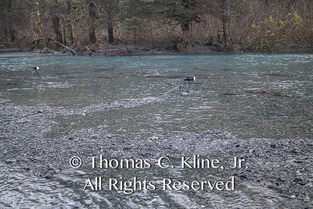

  11. Is that your typical lighting setup for those shots Tom ? It's a bit hard to see in the picture. Could you describe it please.
    Steve
  12. Is that your typical lighting setup for those shots Tom ? It's a bit hard to see in the picture. Could you describe it please.
    Steve
    The photos you see above were taken with that set-up. The EOS-M shot was taken during the shoot - same fish are in the topside and UW shots. Basically it is a Seacam housing with a D2X inside and a Seacam Seaflash 150D strobe with diffuser mounted on an A-frame rig made up of a blend of parts from various companies. 10.5 mm lens and macro fisheye dome port.

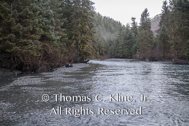

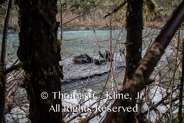

    I used this same rig yesterday and did some shots of the setup as well - it is the housing located to the right, downstream (third pic, the one that is closer to the set ups). The other Seacam housing has a 1Ds3 with 8-15mm fisheye inside, a wideport and the Canon version of the same strobe. Fish are Coho Salmon. It is very shallow, you can see the dorsal fin of the alpha males sticking above the surface. It has been a relatively warm and wet autumn so the stream is high and still slightly trubid with glacial sediment. The stream was much higher during the summer - you can sort of see this by the sediment leading into the forest and the stripped surface of the plants. The stream should be about half this width in about a month since flow will slow once it gets below freezing. The shot of the actual spawning is cropped, the other not cropped.
    Tom
