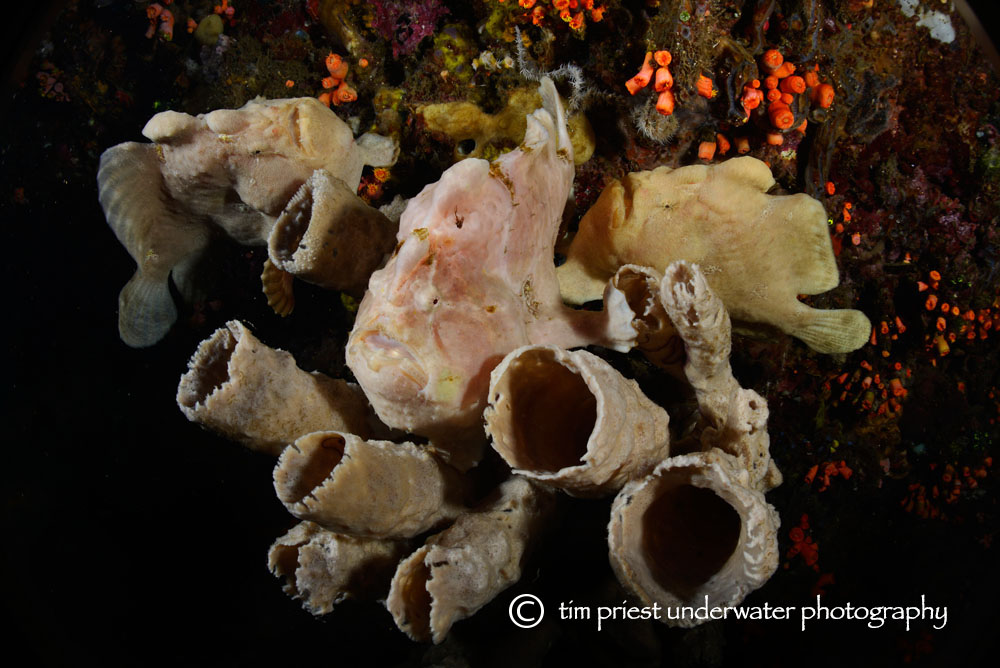

    This has been discussed quite widely on Wetpixel, and FX cameras need big domes with wide-angle and fisheye lenses, otherwise suffering from a marked loss of sharpness at the edges of the image. Big domes, of course, make it impossible to light CFWA subjects when they are very close to the dome. I've tried a slightly odd Nexus dome, designed for an old Nikon kit wide-angle zoom which is a small segment of a large radius hemisphere, but it's far from perfect and needs a 1.5x teleconverter on my 15mm. I think that a middle-sized dome is probably the best option: ie one of the Zen 5" or 6" ports...
    Sigma 15mm + Kenko 1.5x teleconverter, Nikon D800, Nauticam and Nexus dome for 18-70mm Nikon lens. Subject distance about 30cm from lens. Two Inon Z240 strobes.
