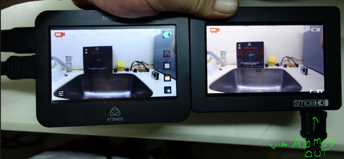

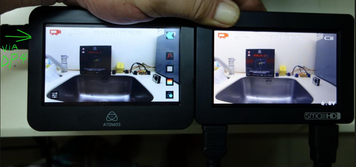

  14. Hi Guys,
    See attachment, hope it shed some light.
    Photo of this type cannot be very good, but at least something to see.
    I have not mess with the Ninja 2 color setting or contrast or whatevere.......at all.
    Video source is from GoPro HD3+ Black. Light is long tube rather cool fluorescent lamp
    The DP4 screen has always been warmer but it is a bit too warm actually in this test.
    One thing for sure, DP4 seems to be a better screen in terms of resolution, at least for me.
    I have DP4 Nauticam and one of the reason I got the Atomos N2 was because I am not happy with focus peaking of DP4 which is only white shade.
    White shade for focus peaking is not so useful UW. Prefer red and yellow. My lousy eyes love focus peaking too... :pardon:
