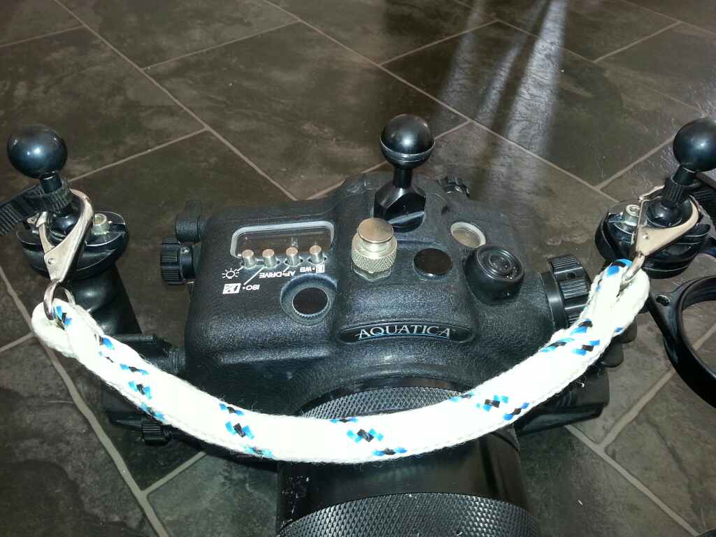

  6. Thanks Stewart for that tip. Now I have come up with a solution that I believe in. See picture:

  8. I have made up length of rope to which I have spliced two quick snaps to. It serves as a carry handle or with one end unclipped from housing it can be then clipped off to bcd.
    Please refer to attached photo.

  9. Another try to show the picture.
