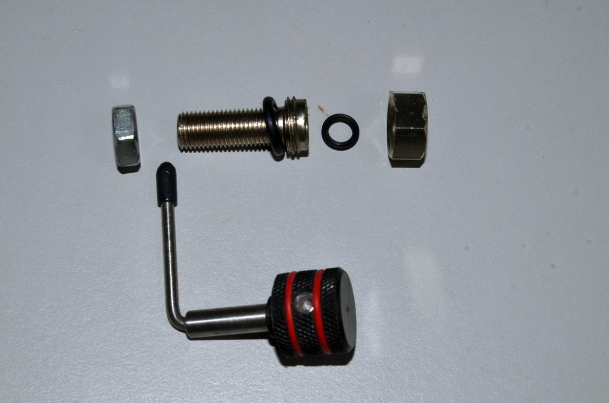

  3. The control parts are actually two pieces. there is a inter piece that has threads on it kinda like a stud and a outer piece that had threads inside it kinda like a nut. You have to remove both pieces and any retaining nut that may bo on the inside of the housing. See the attached picture.

    It's the threaded bolt in the middle of your picture I can't remove. I've got the outer nut off as well as the control and have no retaining nut fitted.
    What do I used to remove the threaded bolt in the middle of your picture? Pliers seem like an easy way to ruin the threads if I ever wanted to replace it.

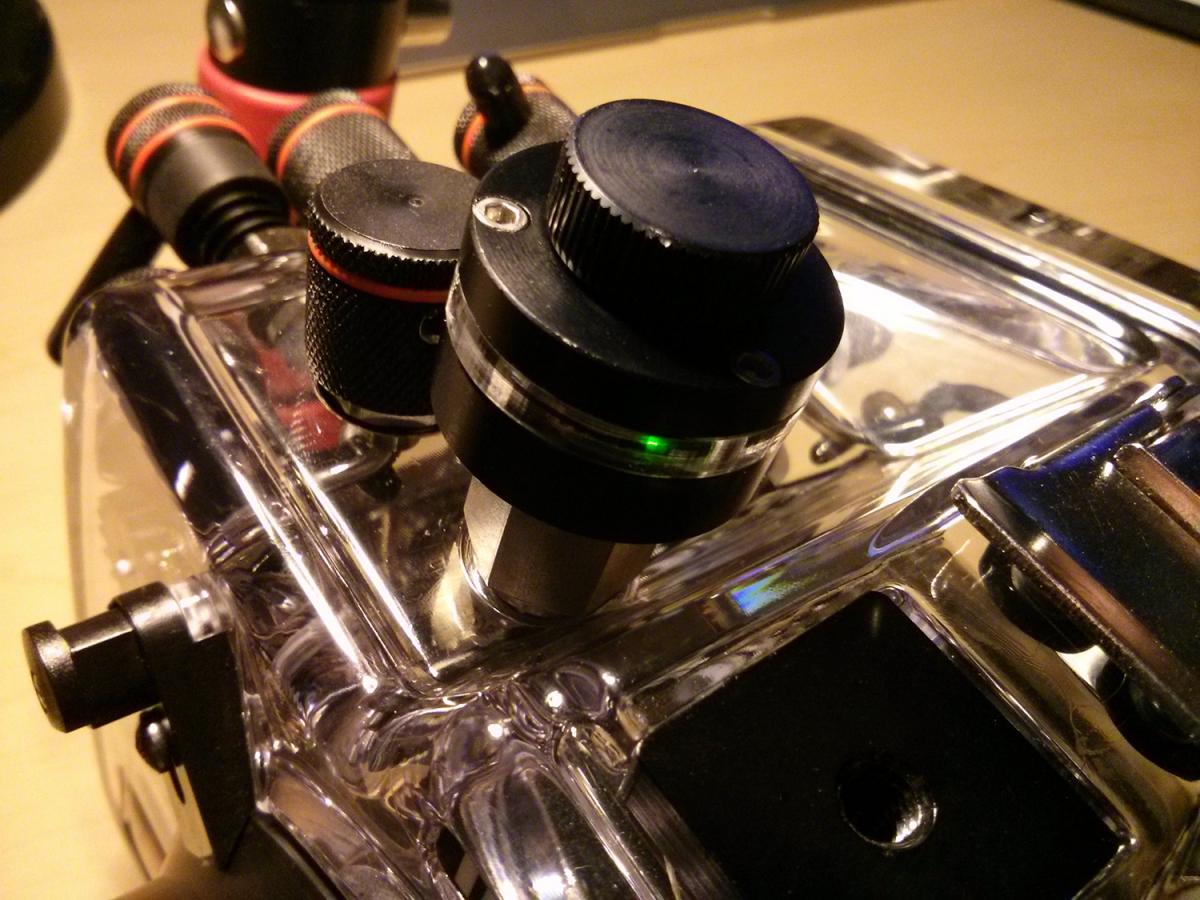

  6. Hi witchieblackcat. Thanks a lot for starting this thread. I recently got a Leak Sentinel V3 for an Ikelite D800 housing, and I ran into the same problem immediately. Were you able to find a good solution? I'm going to give one of blibecap's suggestions a shot. I really appreciate those. They sound like great ideas to me.
  7. Update: I just managed to get the Leak Sentinel installed! The oddball threaded bolt trick helped get it started, then a pair of long nose locking pliers (with a bit of electrical tape on the tips to protect the threads) helped twist it the rest of the way out. Thanks for your help blibecap!
