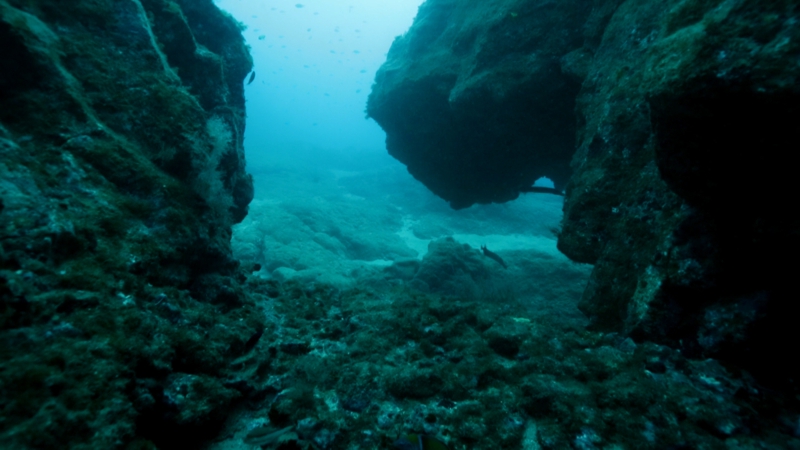

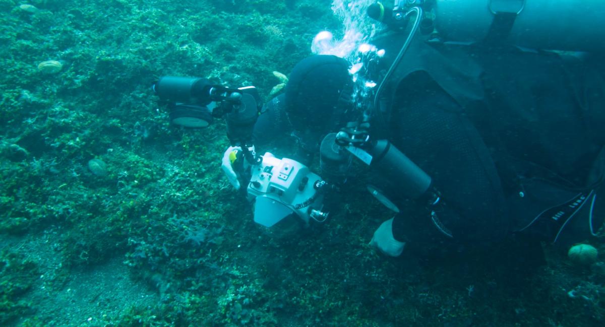

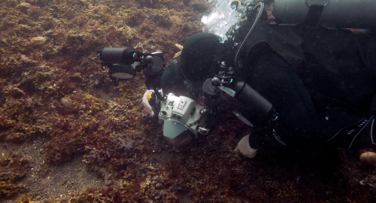

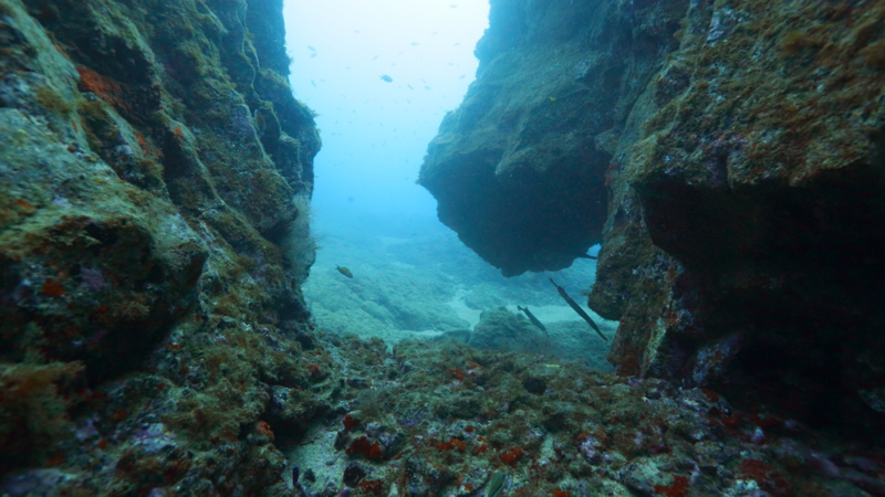

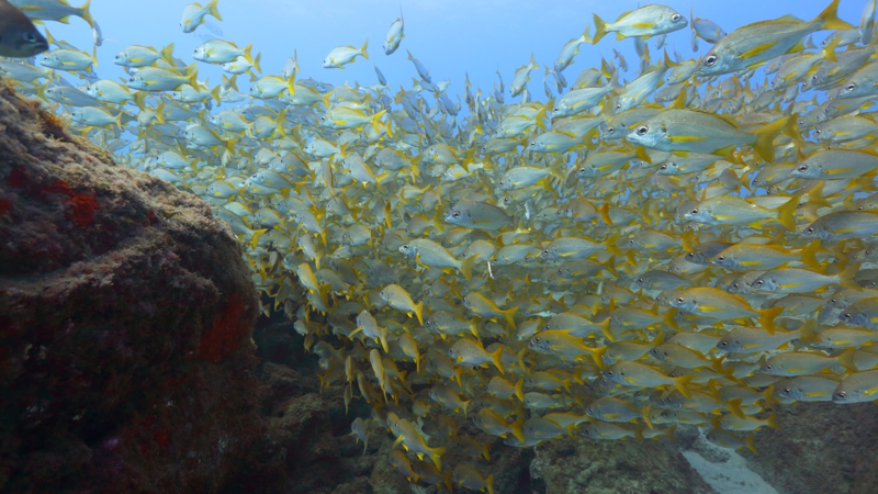

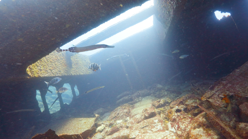

  2. Here are some test pictures as pairs. The other one is a frame grab from HD video. The colors and white balance of which are affected by the manual white balance setting and picture style setting (neutral) of the camera. The second picture is a raw still picture.
    My point here is that the camera can "see" a lot more of the depth dependent colors like red, yellows, browns (and greens). But the white balancing of the camera cannot (or atleast I cannot) sufficiently recover these tones.
    The first pair was shot at 13 meter depth and the white balancing was done against light sand at the bottom. Notice how much there is/could be reds in the picture. Still the whites (in the raw picture) are correct,

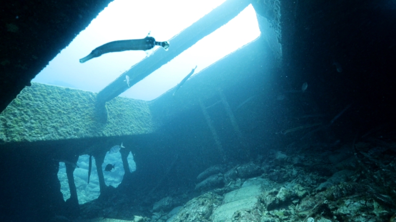

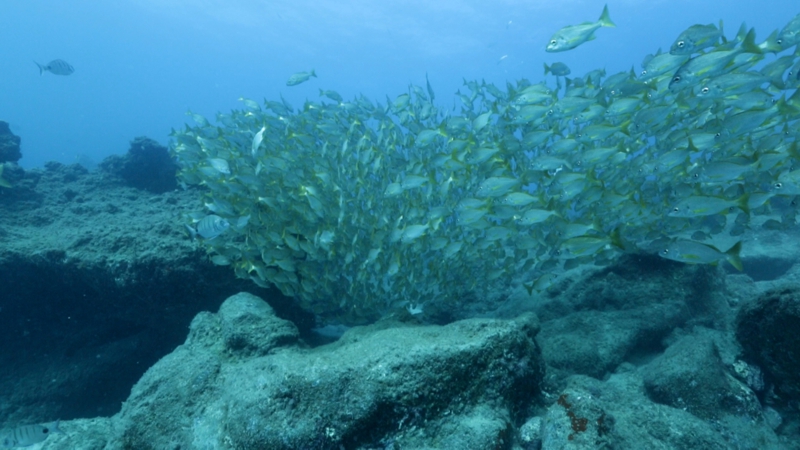

  3. The second pair was shot at 18 meters depth. Notice how the yellow of Roncadores fish is lost.
  4. The third pair was shot at 25 meters depth. The white balancing was done manually against a white balloon. But the video frame grab misses the dark reds and browns that are clearly visible in the raw still picture.
