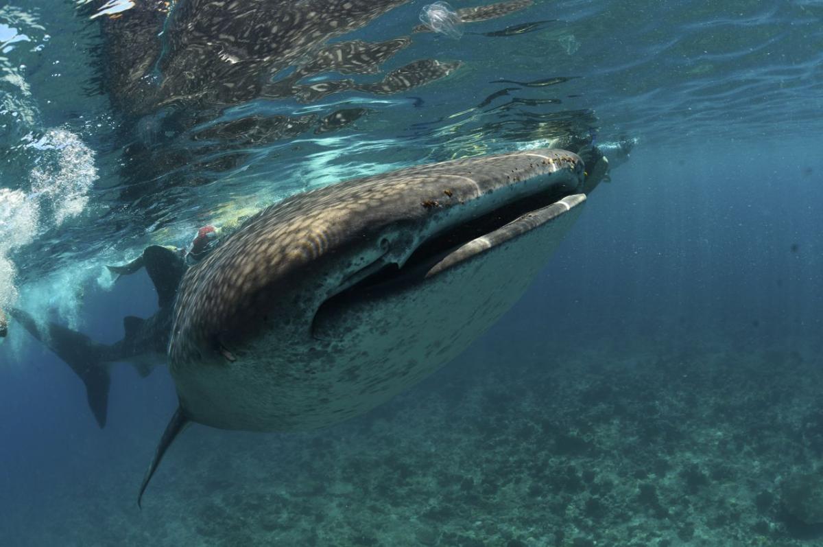

    I've had much more difficulty with whale sharks, and I've been shooting underwater for a while:
    Whale shark and snorkellers, Maldives.
    Unprocessed jpeg; Sigma 15mm, 9" Nauticam dome, ambient light.
    Edited by tdpriest

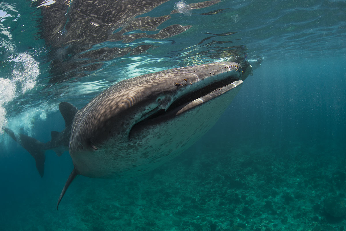

  9. I blur a duplicate layer (Gaussian blur at about 15 pixels) and add a little noise (1-2 pixels), then I mask the layer (black) and paint over the backscatter with a small white brush (25 pixels diameter).
    Thanks for the tip, I'll definitely try that next! Maybe leaving more imperfections in the images will make them look more natural as well..? I don't know what other people's impression is, but when I look at my pics now, I don't really get the sense that the viewer would be "present at the location". In comparison, when I look at your pic, I can totally imagine being right there swimming with that whaleshark. Do you think that's a matter of composing the shots differently or trying to take it a bit easier on post-processing?
    Generally I'm quite happy with my pics (especially since before the trip I had had several nightmares where my camera couldn't focus or malfunctioned some other way and I missed all photo ops), but since I'm keen on improving, I'd gladly let you guys pick them apart. :)

  12. ... when I look at your pic, I can totally imagine being right there swimming with that whaleshark. Do you think that's a matter of composing the shots differently or trying to take it a bit easier on post-processing?
    I think that two or three things help: the shark is very big in the frame, it's coming right at the viewer (I dived underneath just after taking the image after this one) and there are some snorkellers, although I tried to hide them behind the shark.
    It's mostly in framing the image at the time, and some luck (although I pushed my luck, and the shark's patience, by finning really hard and getting into position several times).
    In processing I played with the colour of the shark compared to the water, the brightness of the shark and the sharpness of the image. It now looks like this (yes, I did cheat and remove one snorkeller by painting in the surface reflections from an image taken about a second later):
    Edited by tdpriest
