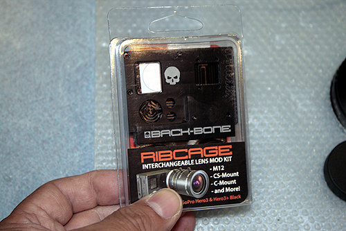

    There is this start-up company called Back Bone (http://www.back-bone.ca/) and they make this kit that could completely transform your Go Pro 3 into an interchangeable lens camera using the M12, CS mount or C-mount system. They come in fully assembled camera based on Go Pro 3+(including the Go pro) or self-assemble kit. Being a glutton for punishment I opt for the kit. Actually I was on my way in becoming their dealer so I thought better try one out. My experience in this particular DIY is like walking on a cliff edge with a gammy leg and blind folded.
    Here is a link to their installation video. Watch it and you know its not for the faith hearted to go D I Y.
    I will post some of my picture in the next post

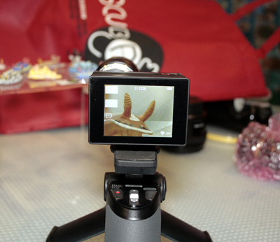

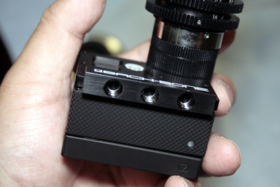

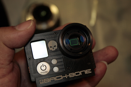

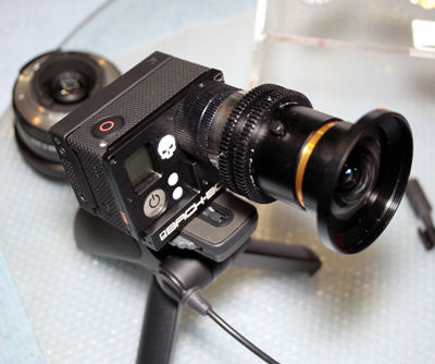

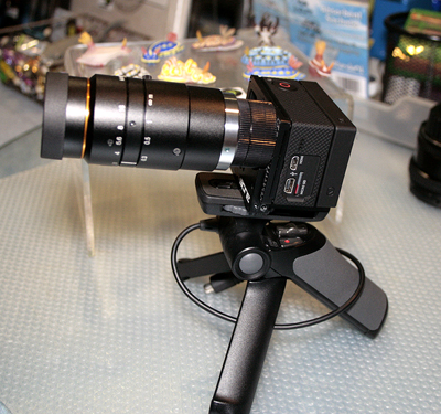

  2. Although the instruction is clear enough and the PDF version lists out all the parts there is this "what is going on moments" when parts simply does not fit. I had a few of those. Also finding the right double sided tape or losing tiny screws in the carpet are the masochistic "fun" of doing this type of mod. Here is the fruits of my labour:

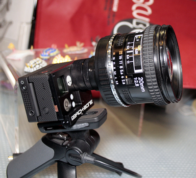

  3. Back-bone did say that the sensor in the camera is best suited to M12, CS or C mount lenses. There are simply thousands of used 16mm bolex lenses and CCTV lenses that is compatible with this mod. I choose a Kowa 5 megapixel lens. I also tried a Nikkor AF 20mm with an adapter. With the sensor crop of 5+ its not really effective. The image colour turned out to be off. It could well be the flange distance and the lack of precise alignment of all the adapter and rings. All in all the C-mount lenses worked well and I manage to get good and sharp digital stills and video out.
  4. Here are some images taken with the mod. Additing a Go-Pro back monitor with touch screen really helps with the focusing (duh!) and the controls. There is no AF and with some CCTV lenses there is no aperture scale. In case you are wondering are the Nudibrachs real ? No. These are made in Japan by a very skillful artist.
