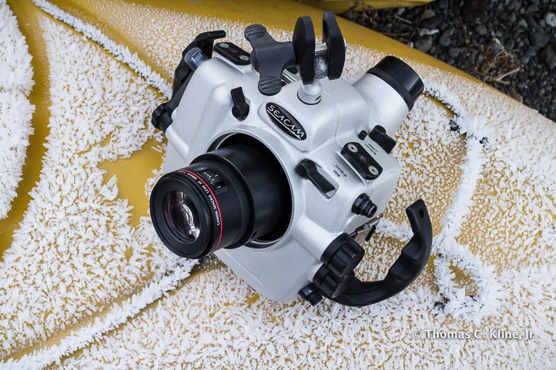

  2. You may want to specify which of the three EF 100mm macros you have. In terms of Seacam I am using the same port for the 100L as for the 105VR (I have both). The manual focusing ring connects with the housing and not the port - see attached pic of 100L in Seacam - it is port length that is important in this case.
    Good luck!
    Tom
