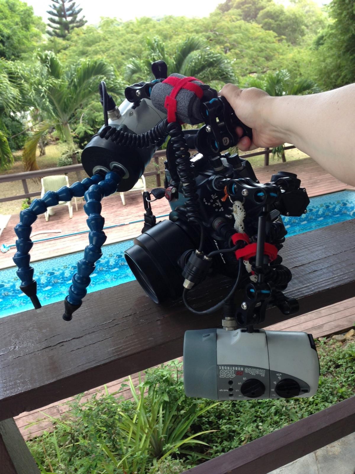

  7. OK, here's a picture with one of the double-snoots. Please don't laugh too hard. I really enjoy DIY projects, hence there is usually loads of ductape, plumbing supplies and insulation foam mixed into my setups.

  8. I think you will find that trying to shoot anything (even a lettuce leaf slug) with the strobes on the camera will be nearly impossible. Putting the strobe and snoot on the tripod and moving from two to one snoot arms will make starting this out way more easy. If your aiming light from the strobe works, then doing this at night will also be a lot easier.
    Bill

  12. Not being an expert in home made snoots I would observe that your strobe has the lamp in the central position and you instead have two snoots on the sides that would need a lens or a diffuser on the back to spread the residual light.
    I would think a single snoot in line with the bulb on the strobe would make things much easier.

  15. OK, here's a picture with one of the double-snoots. Please don't laugh too hard. I really enjoy DIY projects, hence there is usually loads of ductape, plumbing supplies and insulation foam mixed into my setups.
    Marjo: reviving this thread. and not laughing, nice job with this. I am building the same fiber optic snoot for one of my Ikelite 125s. What product did you use to cover the strobe and screw the loc-line into? Is it adhered or screwed to the strobe in any way?
