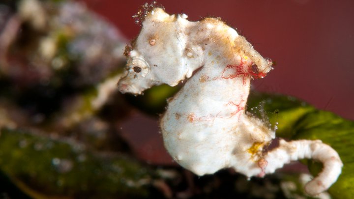

    Actually at the magnification of a +10 Sub See all I can do is get a single focus rectangle on a pigmy. Here is a writeup from yesteryear on the process. A very small pigmy in very low resolution from that presentation is attached. It has been formatted for the presentation but is full frame.
    That was 2011. I have increased my technique since then but no interesting pigmys
