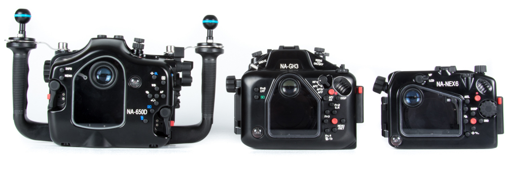

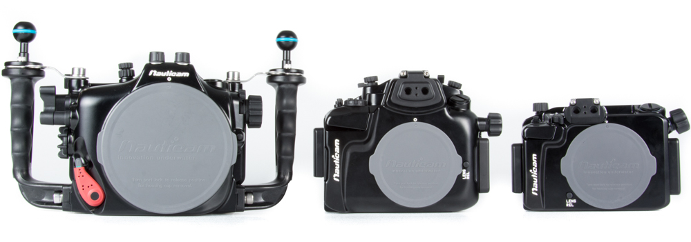

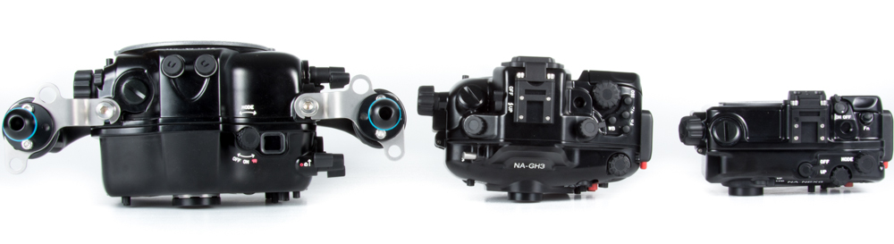

  6. Here is a quick comparison of NA-650 for Canon Rebel T5i, GH3, and NEX-6:
  7. Perfect, thanks a lot! Just the thing I was looking for :) From the pictures I seems like the housing for the GH3 is significantly smaller than the T5i (disregarding the handles), and only a little bit bigger than the NEX-6. Makes me a bit more confident about the size of the housing for GH3 and 4 in regards to my taste.
