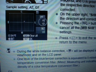

  1. Am curious whether any of you have tried to replicate underwater filters with in-camera color temperature and/or tint (eg, magenta or amber shift) adjustments? The ideal would be the creation of a chart showing Kelvin levels and Magenta/Amber shift for water type (e.g., tropical blue or green) and depth.
    I shoot with a Canon 5D2 but have not been wholly satisfied with manual white balancing for video (without video lighting). As an alternative to external filters, I wanted to experiment with setting color temperature and tint (toward magenta and amber) depending on depth and water type (blue/tropical vs. green) as an experimental alternative to custom/manual WB setting. Manufacturers do not appear to publish these specifications (e.g., the 3 flip filters for the GoPro, the Ikelite filters etc…).
    Fundamental Question: when you set a custom white balance, does it impact magenta and green? I assume (probably incorrectly), that only the relative blue and amber levels are adjusted. If so, boosting magenta levels at depth would also seem to make sense.
    My Canon enables me to set color temp (obviously) and a color shift to any of Blue, Green, Amber or Magenta (Canon claims these adjustments are equivalent to color correction filters). See chart for how the Canon can make these adjustments. Just trying to get in the ball park to compare to manual white balance results with video (sans lights).
    Thanks.
    Jim
