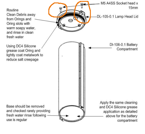

    I agree the Orca SeaWolf light is a fantastic LED light. Great even light and colour rendering. Clever way to transport and use of high capacity rechargeable batteries. One thing I don't like is the opening and closing of the canister. Two hex bolts and only way of opening is use a blunt flathead screw driver next to bolts. I am going to suggest Orca provide some sort of snap latches or even a thumbscrew. Great light and output is 22K lumen as specified.

  4. Errr you lost me there. Which part shows the re-design? The method is still "The top plate attaches to the cannister via two M5 allen key bolts"
    I carry a set of allen keys but what if I didn't? I have two sets of these lights and I have to change it to M5 thumb screws. I also carry a little "crowbar" to prise the lid open :) The piston o-ring lid works well so well that it create a reassuring cushion of air when the lid is close and the thumb screw is handy for securing it down with one hand.
    I am designer myself and ergonomics and ease of use is important. Don't get me wrong I am just pointing out one issue not a big deal to some but it is to me. So what if the M5 bolts could be made more user friendly? Anyway I hope I have not upset anyone. If I have I apologize. These are terrific lights first and foremost.
    If there is a new design then lets me see I could update it.
    Dive in peace...cheers
    David

  5. Errr you lost me there. Which part shows the re-design? The method is still "The top plate attaches to the cannister via two M5 allen key bolts"
    Tail end of the same paragraph.....
    The top plate attaches to the cannister via two M5 allen key bolts, seal is via to large barrel o-rings. The plate needs to be inserted in the right position, then the bolts alternatively tightened to slowly draw the plate into place. This takes time and care, arguably a good thing to ensure that you've fitted the lid properly, however it's something that would become frustrating over time, especially if you are trying to install a fresh set of batteries in a rush. OrcaLight have confirmed that they are testing a new fitting method, incorpating a thumb screw and latch attachment, that will make removal and replacement of the lid far easier without negating the integrity, they will also be incorporating a connection point for the battery charger into the plate to alleviate the need to remove batteries for charging.
    Edited by Stuart Keasley
  6. ah I see. I must be blind
    Thanks Stuart
    Great to see that. I shall have my canister lids updated.
    David
